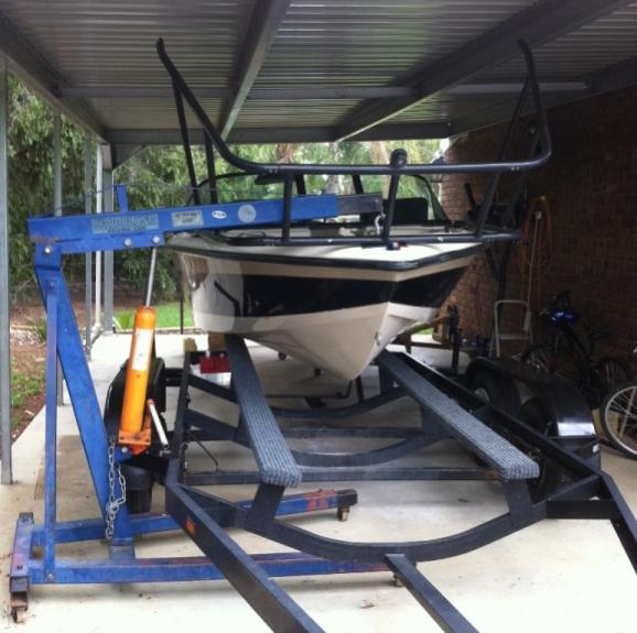

              All SN196's used a 91" 2.31m beam. I have a 98 sport which also uses the 91" beam. Imported it with trailer to Australia and modified original DHM trailer. It is 10mm under the 2500mm max width.
Name:	98 Lift 2s.jpg
