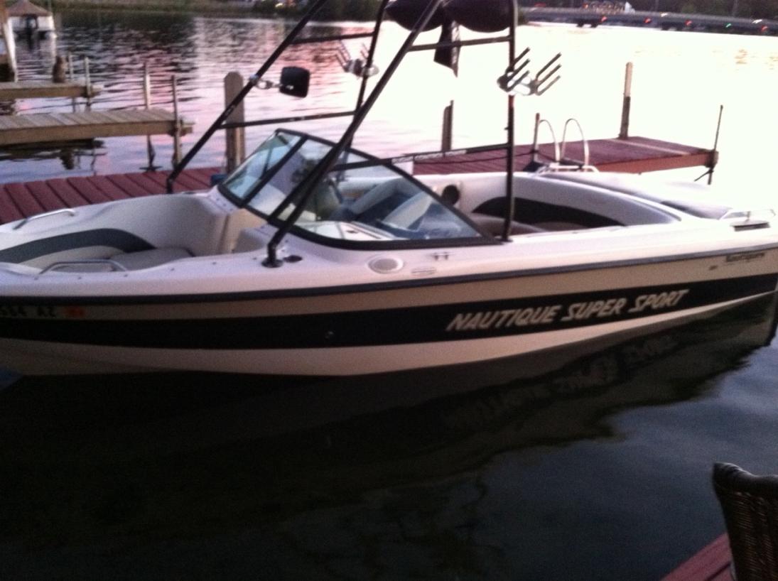

            I am leaning towards powder coating it black to match the windshield frame but I always love the way white towers look. I also think it might look good if I could match the tan top stripe. The other option is to leave it polished but I think that looks best when the windshield frame is also polished. I will probably go black but I would be interested in hearing feedback on those 4 options. Here is a pic of my boat:
