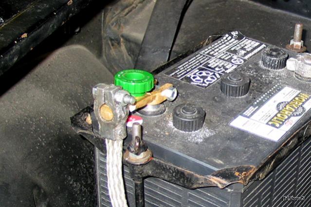

            Even a simple switch like this would allow you to keep battery from draining when not in use. Of course any automatic bilge pump won't run either.
              http://www.autozone.com/autozone/acc...er=835218_0_0_
              Not a bad idea. Sure seems easier.
