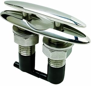

            Another question on the topic. Is the gunwale strong enough for the cleats?
            This is the cleat I plan to use. http://ecx.images-amazon.com/images/...oL._SX300_.jpg

              Does your boat have any existing cleats? If so I would look at the backside of those if you can to determine if they used any backing plates or beefed up the fiberglass. To be safe it might be a good idea to use an aluminum backing plate or beef up the area with some mat and glass like you would for tower supports.
              Do you have a link for those cleats? I have been contemplating replacing my midship cleats with pull up ones and also adding a set near the stern of my boat.

                generally the strongest fiberglass will not be a big open panel of fiberglass... but near a corner, or near a bend... or perhaps 2 coners or bends like the top of a gunwhale, perhaps only 3-4" wide. Those corners and bends reinforce, and reduce flex.
                Those smaller spans of fiberglass will be stronger and have less flex under extreme loads... as compared to a huge wide open panel of FG, like the broadside of your boat for example.
                When you get into extreme applications... like adding an aftermarket tower, or lifting rings..... they are almost always near corner to reduce flex AND the backsides are reinforced with some type of backing plate to distribute the load over the largest area possible.
                  http://www.amazon.com/attwood-AT-20-.../dp/B001O0DKMA

                    I used oem Nautique cleat last year and they have a MUCH larger backing plate then Attwoods. I also use a new step bit to drill the holes, it bevels the gel coat for you.
