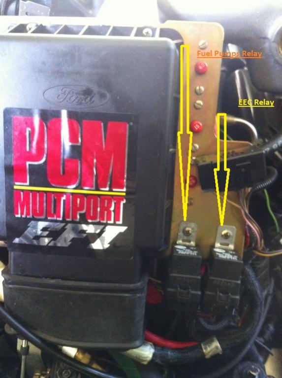

    Does anybody have a picture or a link to the 20 amp fuse for the fuel pump?
    I can't find it anywhere! Embarrassing....

    this one?Click image for larger version

      The early GT40 without the FCC had a 20 amp fuel pump cct breaker. The later motors with FCC only have a 15 amp breaker. The 12.5 amp breaker is for the ECM
      • Lewy2001
        • 63
        This picture shows the 3 breakers the main 60 amp the fuel pump 15 amp and the ECM (EEC) 12.5 amp.
        Located above the relays.
