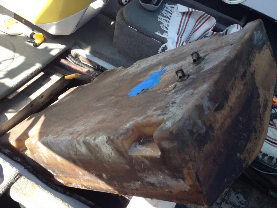

                Here I am propping up the fuel tank after removing the fuel. The level sender has to be removed and I taped over the opening with masking tape. I put a 2x4 under the tank to keep it tilted up.
