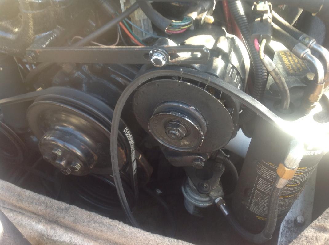

    I need some help with the GT40 in my 97 Super Sport. As we accelerated away from the dock today I smelt burnt rubber coming from the engine. I stopped to investigate but didn't see anything. As I started to pull some tubers I smelt it again and then a belt snapped. My wife tried to pick up the belt and she said it was extremely hot. Obviously it got so hot that it snapped. What would have caused this. I posted a picture below of what belt it was. It's the one just dangling there. These are fairly new belts as well. Thanks for any tips.

                  If it was burning the belt and it was the correct belt in new or excellent condition and nothing was rubbing against it then it was slipping. This can only happen if something is not turning or not turning fast enough, something is out of alignment, or the belt was too loose. The alternator is used to adjust tension on the v belt in that picture. It looks to me that the head of the adjustment bolt has been rounded off a bit and it is also situation such that it is about 1/4 as tight as it could be. If it was still in the "tight" position in that picture there is not much adjustment left to get the belt on and off. If the bolt was a little loose and it had just started to slip it could have started spinning and eventually thrown the belt. Before you loosen it see if you can move the alternator and pay attention to how tight the bolt is when you do loosen it, if the bolt is rounded off to where it doesn't allow you to tighten it enough then replace it.
                  If your water pump and alternator turn as freely as they should (even if they turn if there is too much resistance then the belt can start to slip prematurely) and also have no play side to side and you get a new belt when you put it on make sure that it lines up nicely between all the pulleys if the bearings are starting to go or the bracket is bent on the alternator and they aren't operating in the same plane it will cause the belt to wear heavily on one side of the belt which will cause it to fail prematurely. If its due to bad bearings or a bent shaft then the offending item needs to be replaced. Sometimes you can put a straight edge across the face of the pulleys to see if they are in alignment sometimes you just have to eyeball it.
