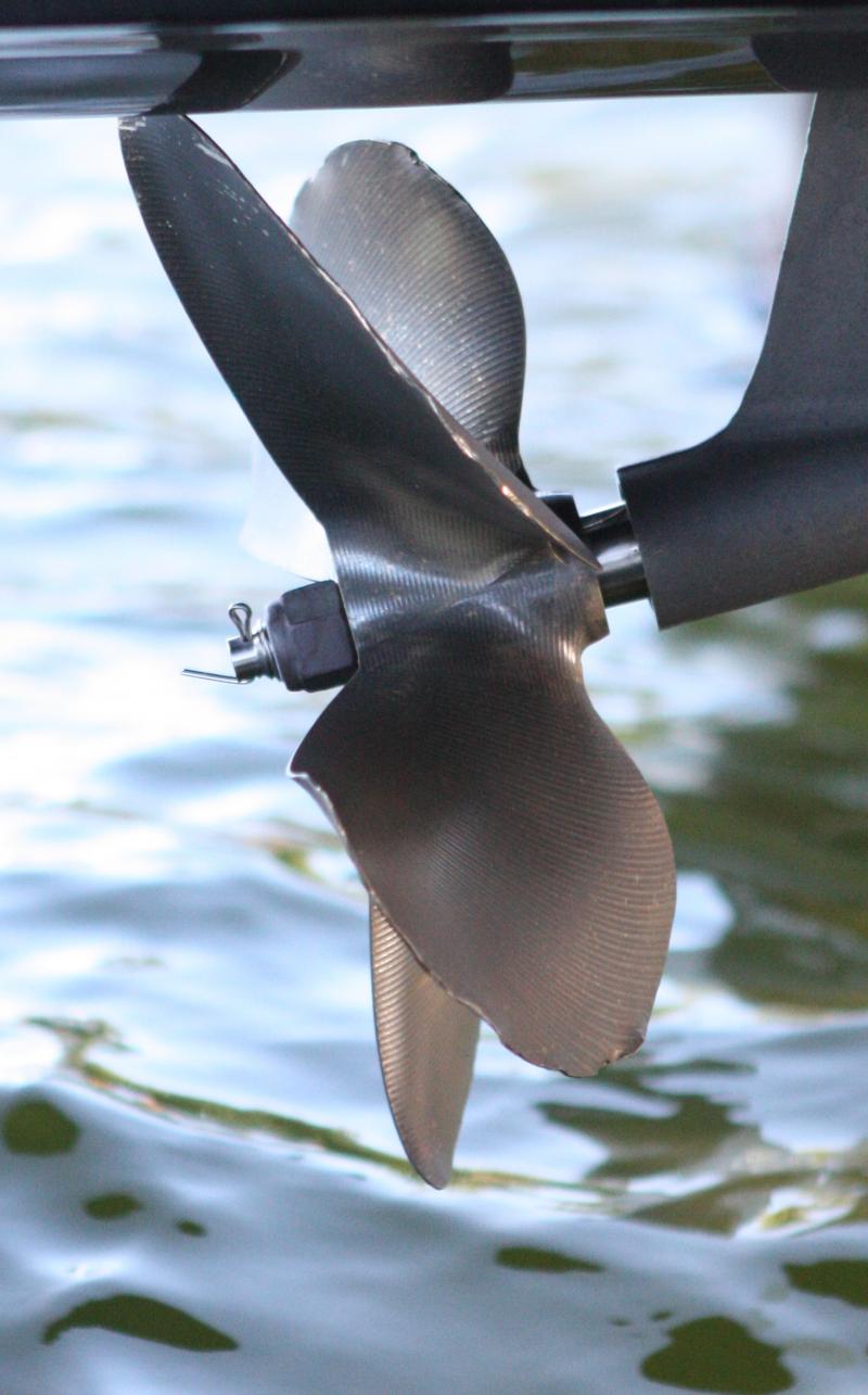

    Damaged prop - testing and options?
    The prop on my boat got damaged and wondering what my options are. I haven't a chance to take the boat out and check vibrations, etc., but am also a little leery of doing it. I'm new to inboards / v-drives so I'm not sure how tolerant they are, given I know vibrations are very bad. Some pictures below.

    You'll feel that. Not sure about the waviness on the trailing edge but the one curled under corner is about what my prop looked like when I dinged it and you would have thought the whole thing was wadded up. I wouldn't operate that, and being in season it might take a bit to get it fixed. You might be lucky enough to have a whole slew of prop repair places nearby so you could pull it and swing it by one, I had to mail mine off for repair. If thats the case maybe order one to replace it and one of those ACME weekend saver kits so you have the tools to replace it then when you get the original back you can carry it with you for emergencies. If you have been thinking about trying a different prop now might be a good time. Check out the sticky on sight sponsors Delta Propeller Company had good discounts that made it the cheapest for my prop when last I looked.

      I believe your choices are to have the prop refurbished, or buy a new one. That prop doesn't look to be in bad shape, so I would look into refurbishing it as they can refurbish props in very bad shape. I wouldn't operate the boat much with the prop the way it is though, as the vibrations are transfered directly up the prop shaft to the transmission.
      A good shop can refurbish that prop and put it back to factory specs. I had mine done this past winter, around here it cost in the $150 to $175 range. Took them a couple of days, but we have multiple shops in the area capable of doing the work. If you have to send it off to them, or there busy due to being in season, who knows how long it will take.
      You could also purchase a new one, which will run you around 3 to 4 times that amount.

        A couple of items:
        - That prop is completely repairable. I've sent props off that looked WAY worse than that one.
        - You need a spare prop. I don't care how good a driver you are or how careful you are, sooner or later you're going to hit something. With a spare you can be back on the water in the time it takes to swap it.
        Recommendations:
        - Buy a spare prop right away. They aren't cheap. Could be anywhere from $450-$650 depending on which boat you have.
        - Get a prop puller kit. They aren't expensive and it's one of those tools you rarely use, but indispensable when you need it.
        - Send that prop off for repair. There are lots of prop shops out there but I've settled on this one over the years: http://www.myinternetpartner.com/~bobbysol/ He isn't the cheapest, but I can send him a prop on Monday morning and get it back Friday afternoon. That goes a long way with me.

          Just had one fixed worst then that, $125.00 dropped off Monday 9am picked up Tuesday at noon. Got lucky he had a bunch of brass props he was doing and mine made it in time.

                  that prop will vibrate as mentioned.... i would consider buying a new prop.... and keeping the old re-furbed as a spare. that's what i did. only i haven't re furbed the old one. upgraded to a acme 422 (preferred for sn). I know the lake and if i ding it i deserve a few days off. I took my prop off on the trailer and I wish it was 5 ft higher. in water shouldn't be a problem and assuming a good lift will handle the leverage needed to get the prop to release. if you do a search here or correct craft .com there are good instructions on how to do it. prop puller (wood block & hammer & presto. (keep the castle nut on until it pops free. prop puller = c clamp with a cut out for the drive shaft.
                      im opposite, I try to keep a new one as back up. That way if you ding a prop u can stick a new one on to make sure u have no shaft damage.
