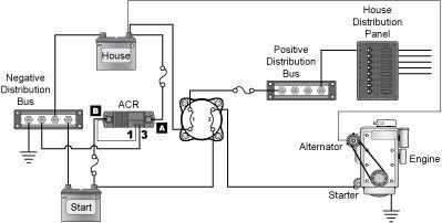

I just received my Blue Sea Systems Add-A-Battery kit This One Here and I am not sure where to run positive wire off of the Alternator to. I tried to do some research on this forum and was unable to find the info to make a confident decision. I did however find a diagram on another site and wanted to make sure it was the right set up. It is pictured below. I am not running a massive setup or anything. Just trying to add an additional deep cell marine battery to my 95 SN 196 closed bow so I can actually listen to the radio for more than 30 minutes without getting out of the water to crank the boat for a bit when we are parked. Can you guys shed some light on if the attached diagram below is correct?
Many thanks in advance.
