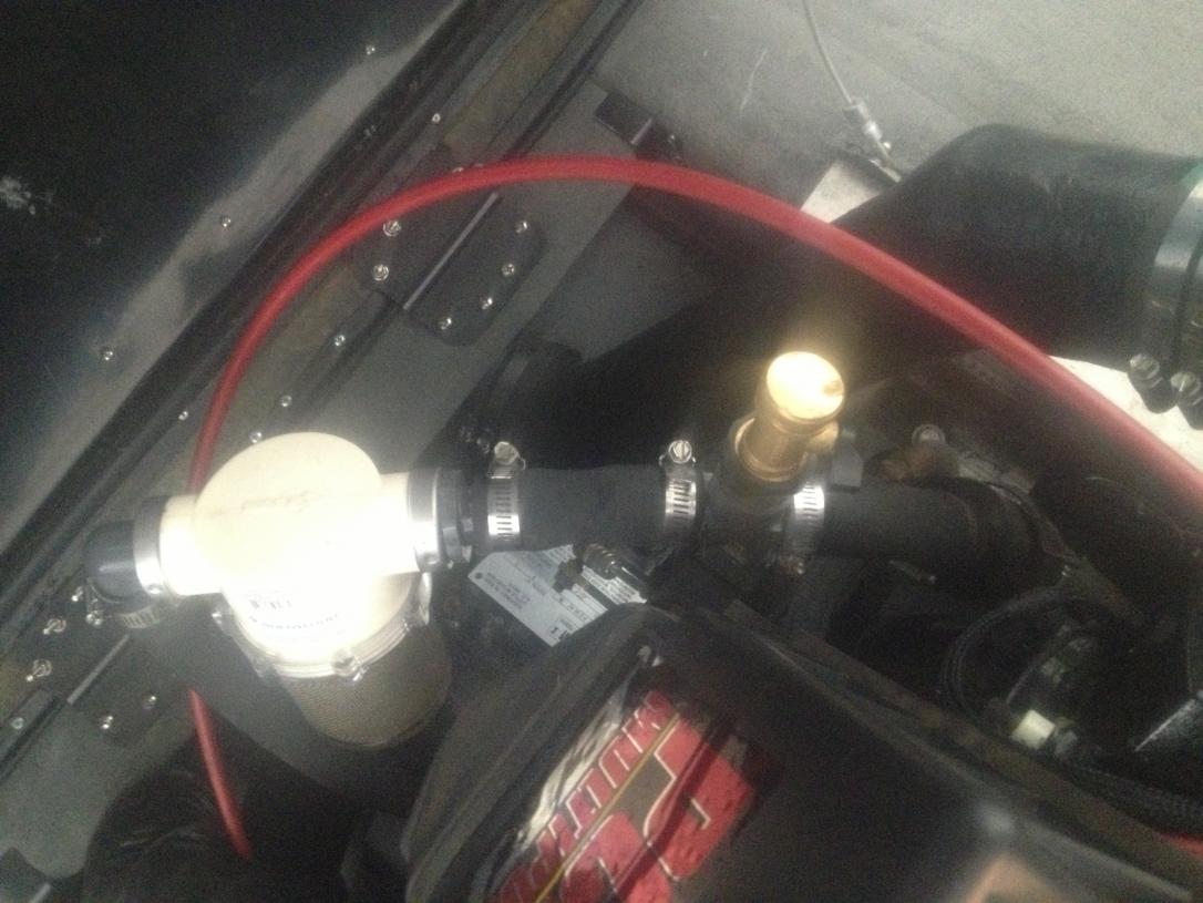

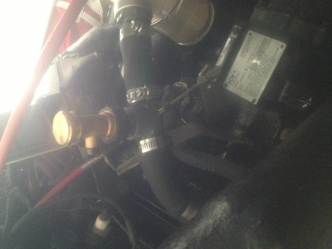

ID:	366470Just make your own. Easily done with parts from hardware store. Here's what I did. I used a brass connection and added a brass cap with gasket. Also, notice the water shut off? To connect the hose I had to make a female to female adapter. Don't think I spent more than 10-15 bucks.

                How about a guy does me a solid and gives me the list of part# for the make my own? I have thought about it, but knowing what a dummy I am would probably require 3 trips to the store. Can you get it all from one store? Please put items in your cart and provide print out.
                    I got everything from lowes. Go to the garden section where hose connections and adapters are. You should be able to find the connection and cap there. Also in that section are the hose clamps needed. For the pvc fitting between the hoses go over to the pvc adapter section. For the female to female go over to the PVC pipe and fittings section. Your are going to have to get two female garden hose connectors and get a male to male to combine them.
                    The hose used to feed the water strainer is 1".
