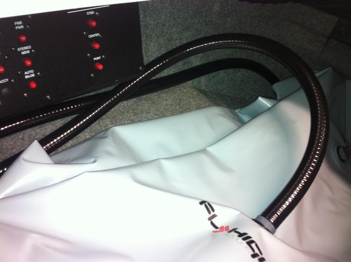

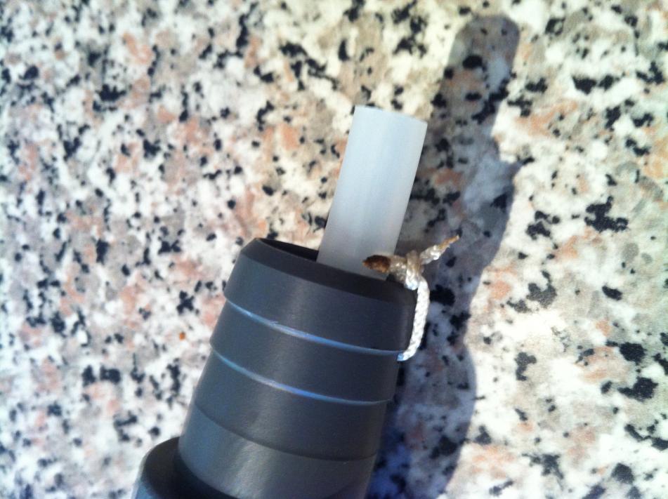

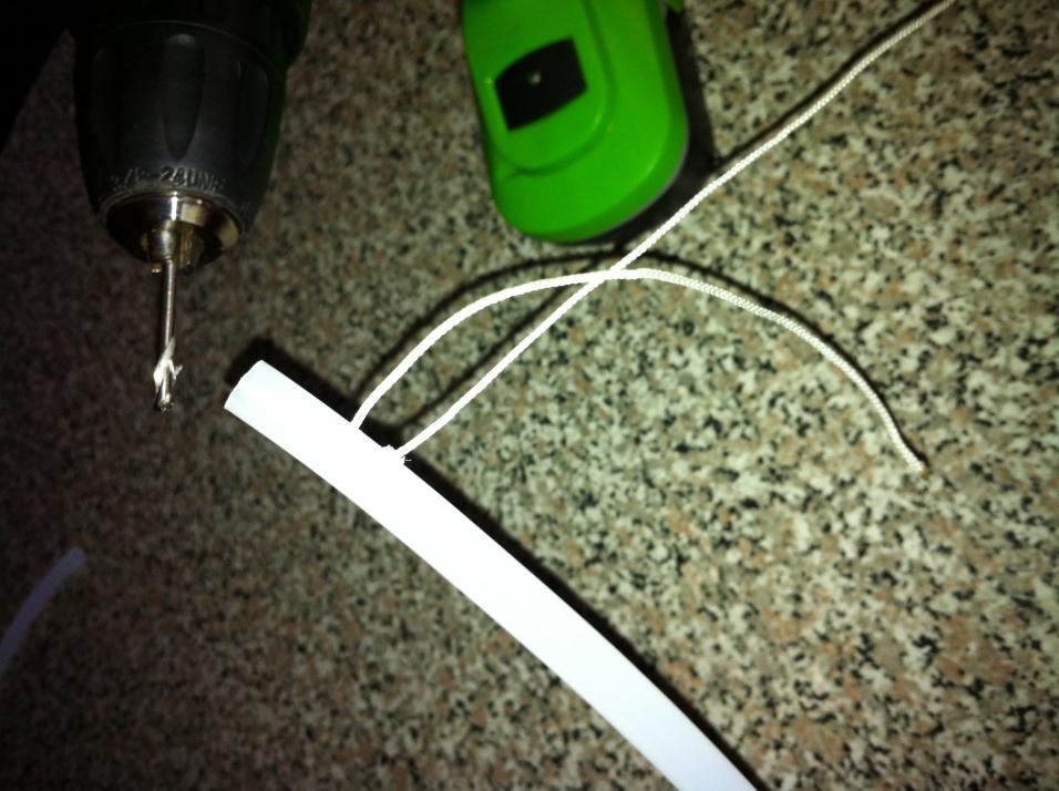

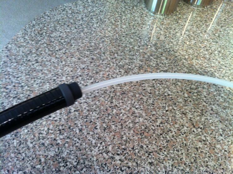

      The difficult part was just threading the cord into the holes I drilled. I chose 3/8 tubing, which made it easier. Once you have the cord in the tube, shown in picture 1, the rest is easy. Just loop it through the fitting like in picture 2 and tie a square knot. The threaded ports in the bag are really large so that went really well. I made the tubing about 1 foot longer than the bag so it goes way into the fill line, that way no worry about it pulling out when the bag gets swapped around. The whole thing took about an hour to do.
      I tested it and it takes 2 cycles of the pump to completely fill and empty. If I were doing it again, I might actually try 1/2 tubing to see if It would empty faster. It's only like $0.50 a foot at the hardware store and I bought 5 feet.
