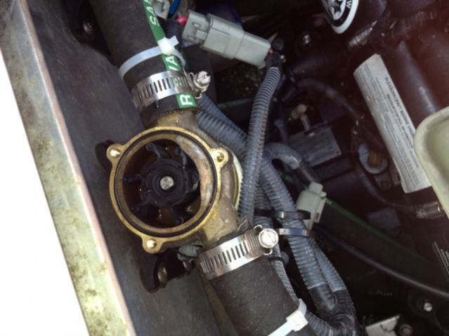

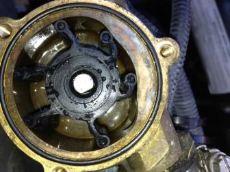

    The belly breaker keeps blowing. I recenlty had the impeller replaced, but I thought I'd take peep at it. Does this look normal?

    That is a different impeller. The impeller should be bright green. You can get one on Nautique parts for pretty cheap.

          get the yellow or green ones.
