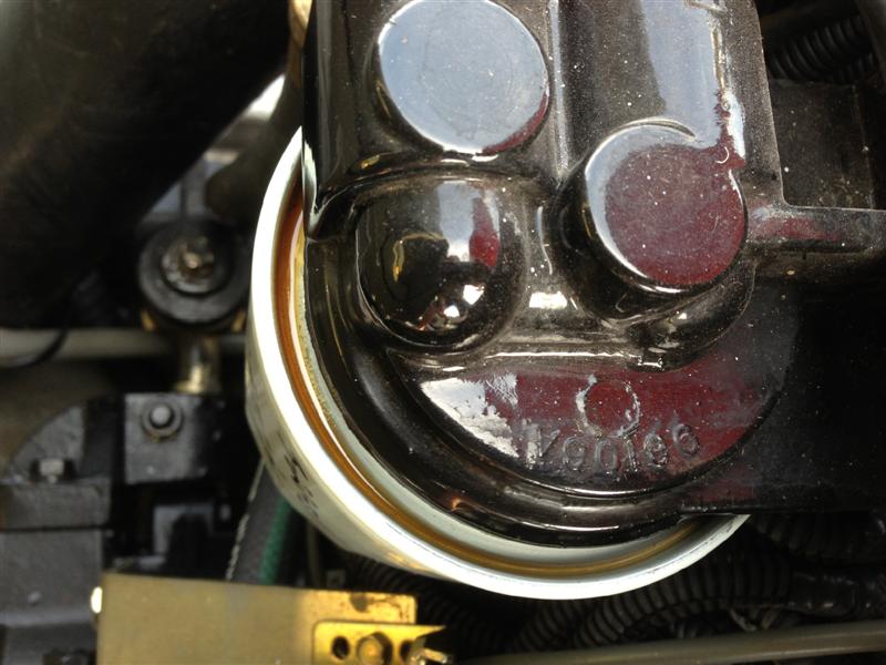

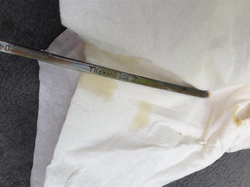

    So I took my boat ('03 AN 216) in for annual service before our week long trip to change trans, engine oil and impeller. So before we launch I check the dip stick while on the trailer (fairly level) and by estimating from the quart low mark I would say it looked like a quart over. So I thought hmmmmm that can't be right. I run for the 1st day and notice I have a little oil in the bilge and on top of the oil filter and its still reading high floating on the water. Oil pressure never got above 46-48 psi or so which is normal for the Excalibur 330. So I call the shop and the service manager tells 1) they suck the oil out and always put 5 quarts back in and that dip sticks on marine motors never read right and 2) back off the filter and make sure an old o-ring isn't stuck on there. I've heard that about marine motors before so I didn't really question it although it still doesn't sit well. So I try to back off the filter and F@$* that sucker is ON THERE. Long story short I had a couple awesome guys with a filter wrench and new filter help me out. It was probably close to 2 full turns too tight. Doesn't anyone else have their dip stick not read even close to accurate? When I bought it last year it was serviced by another dealer (Nautique) and oil was always spot on.

                          I would start over by fully draining and then refilling as having too much oil (like 1qt extra) is just as bad for the engine as not enough as it will cause the oil to foam and negatively reduce the amount of lubrication being provided.

                            Pics
                            You can see the oil pooling around the top of the filter (then drip down into the bildge and on the dip stick, it comes up past the "O" on "DO" not overfill

                              Of interest - if the dealer who did the change really just loosened the existing filter to make sure there aren't 2 o-rings instead of one, that means they didn't change it! So... 1 qt of dirty oil in the filter plus 5 new quarts of oil is 6! You over by a good 1 - 1.5 quarts!
