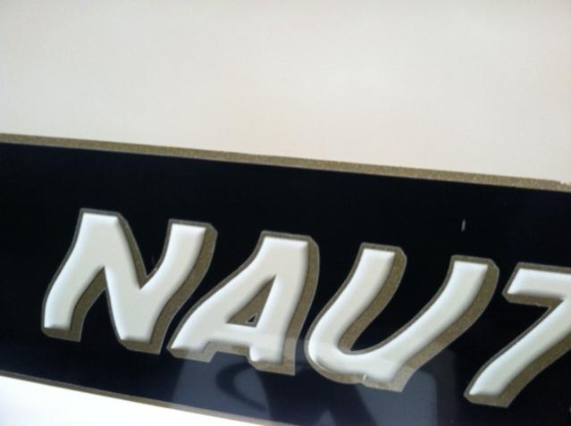

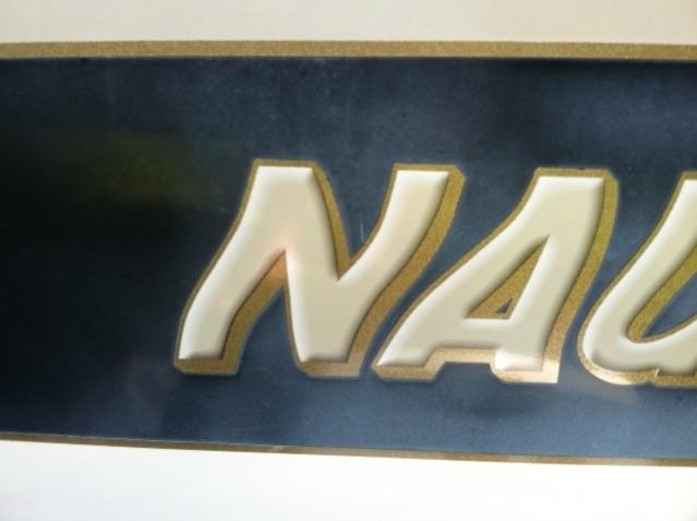

    All it takes is some elbow grease and time with a buffer to get rid of oxidation so I wouldn't worry too much about that. For example here is a before Click image for larger version

ID:	366127and after pic of mine when I got itClick image for larger version

ID:	366128 I used 3M compounds, polish then Collinite wax. Let me know if you want more info on the steps I took to bring back the shine.
