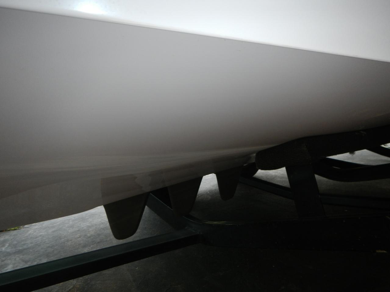

    Worn Bunkers caused hull rash
  • cragginshred
    • Aug 2011
    • 45
    • Tuolumne, Ca.
    The above pic was taken tonight when I noticed pretty significant scratches along my hull that line up with bunkers and are the same width. I had not noticed any wearing with the carpet, but plan to inspect it more when the boat is launched in the am. Ideas out there for buffing out my hull once the carpet is re done? what is the best method to go about replacing the carpet? Any links to recommended products or how to videos?? Thanks!

            When you power load, unload the boat you stir up sand ,dirt and small rocks some end up on the bunks. When you shallow load the boat you are driving up on gritty carpet and scratching the gel. The cure is to always put the trailer in deep and float the boat almost to the bow stop. Not only does it prevent the scratching it will also increase the life of the bunk carpet.

              It's not just because of power loading...it is mainly because of dirt/grit in your bunks. Dirt/grit gets there with the trailer just sitting in the (often dirt or gravel) parking lot while we're out on the lake.

                Previous owner power loaded it, not me. Likely bunks needed to be wet before soft load. Thanks,.. good to hear it's common.

                      Depending on how deep they are buffer may not be aggressive enough, try buffing if no go you will need to wetsand and then work your way back. If the scratches are really deep you may simply just want to polish the area so they are less visible.
                      Dirt could be a part of the problem however unless the gel is slid across the dirt it will not scratch, so the real issue is power loading.
                      On both my colored hulls, float them on only and they do not get scratched, kind of a PITA but so is wet sanding the scratches off regularly.

                        'Discount inboard marine' is a great resource too,.. they advised me to get a product you get from a automotive paint supplier. It is written down in my truck I will post the brand when I get a chance.
