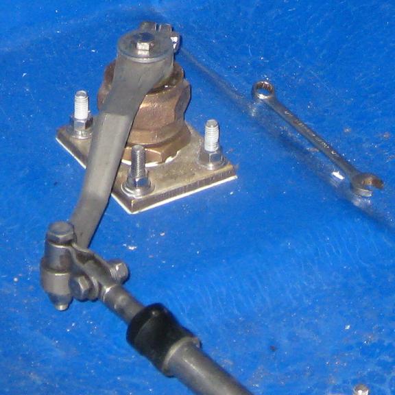

Well I inspected my boat this past weekend to see if I would need to take the tanks out to change the cable. It looks like there is enough room in between the two tanks that I can disconnect the rudder are (pittman arm) and unbolt the cable clamp and pull cable out from under the gas and ballast tanks. I can't disconnect the cable because it is just barely under the ballast tank. Is removing the rudder arm with the cable a bad idea? It seems like it would prevent a lot of wasted time in tank removal. My other question is when you disconnect the rudder arm from the rudder will the rudder fall out of the bottom of the boat? The attached picture is not my boat. It is just for reference. Thanks TRBenj.

You have to take out at least one tank to get to the tiller-end of the cable. There's no way around that. Yesterday I replaced the steering cable on my 1999 Air. I didn't completely remove the fuel tank but it would have been much easier if I did. I disconnected it enough to get it to slide forward so I could remove the port ballast tank. I then disconnected the bottom drain hose from the starboard tank so I could lift it up a few inches and pull the floor plate out. From there I could squeeze into the ski locker (I'm kinda thin) and get to the cable and rudder connections.Do I have to take out the ballast tanks and gas tank to change the steering cable on my 2002 Air Nautique (NOT SUPER AIR)? I seem to find conflicting answers. Has anyone done this and if so how long does it take?
I was by myself and it took around 5 hours.
-Charles
Please post photos of your locker/tank area. The only explanation I can come up with is your 01 does not have factory or OEM tanks. With the OEM tanks it's impossible. They will not lift more than a couple of inches before getting pinched in the gunwale at the side of the fuel tank. In addition, they had a drain in the bottom that went down to the pumps. That hose connection was just a few inches long and couldn't be reached with the fuel tank in place.
There's also a removable floorboard right under the tanks with 3 holes in it. One for the rudder stuffing box, and one each for the L and R tank drains. This floorboard has to come out because it's right over the cable connection points.
