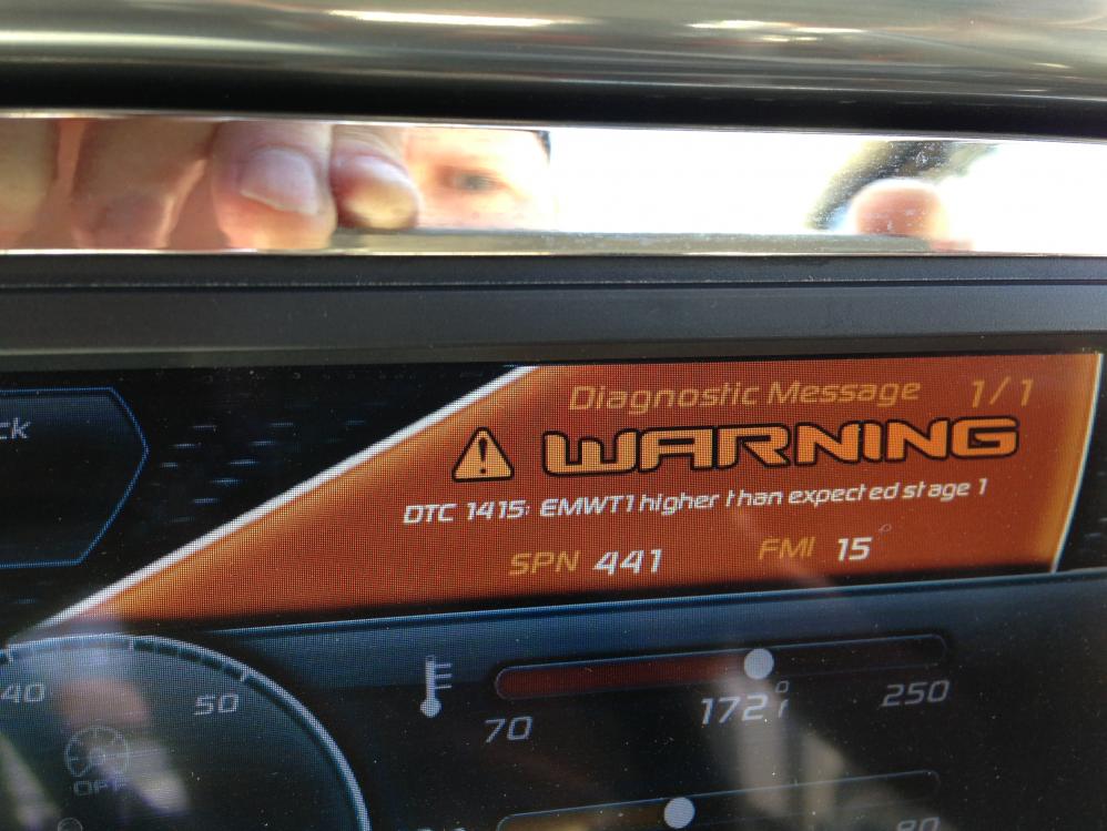

I took my 2012 210 SANTE out on the delta yesterday for the first time, and experienced a cryptic error code (see photo). "DTC 1415: EMWT1 higher than expected stage 1". I immediately called the dealership (Buxton Marine, TX) and they told me that this was 'known issue' and they've already seen a handful of cases from the 2012s. Anyone had an issue with this? The service tech at Buxton told me this is a problem with the impeller that cools the exhaust manifolds, which results in External Manifold Water Temp (EMWT) getting too hot.
