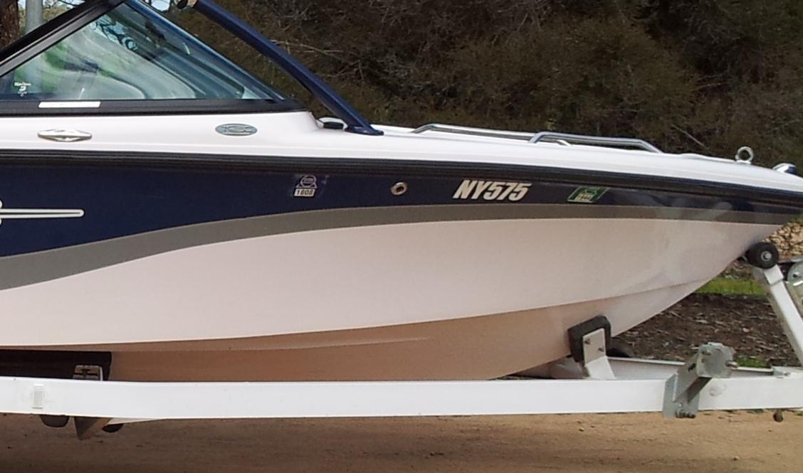

    hopefully just a simple one for the experienced.....
    what is the best product / method for removing the old registration labels?? our local ones only go onto the windscreen
    mine has a couple on each side and would like to remove them...they didn't seem to want to just pull off easily
