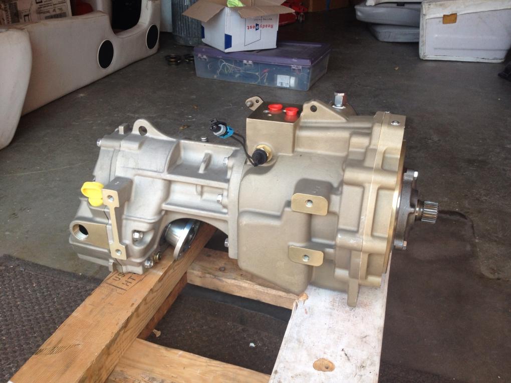

                      Finally got the part. Getting it in was a bit of a bear because of its size. I used a winch and some straps to get it in the boat and lined up.
                      Now waiting on the shaft from Elberts. The shaft needs to be 4" shorter than stock.
