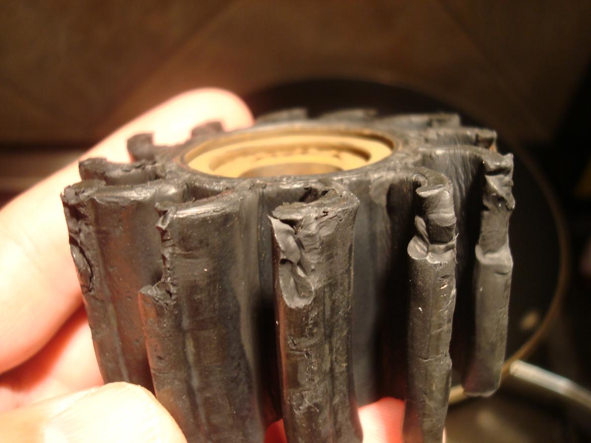

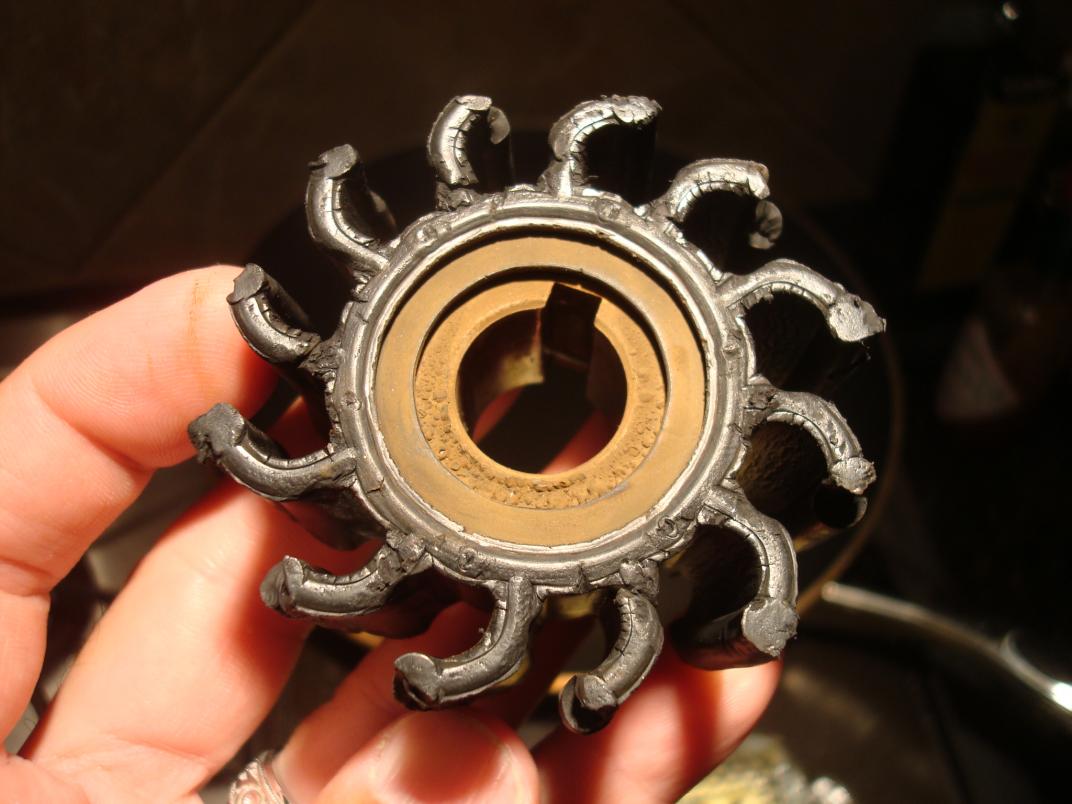

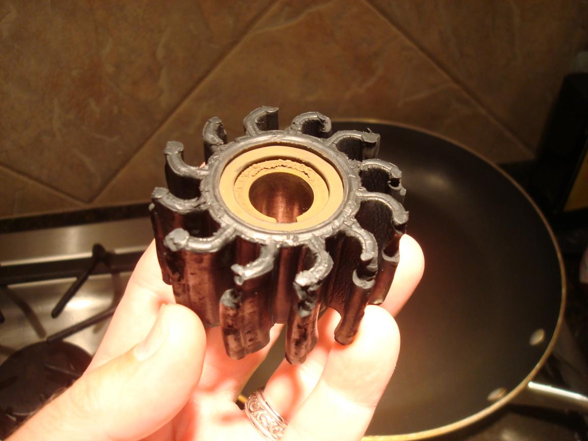

                  If you have ever had that feeling that you were really glad you did something, then you know how I feel. I just hit the 500 hour mark went through the standard maintenance items which included the impeller. The impeller had been changed each season or ever 100 hours, whichever came first, by the PO. This was my first impeller change experience, and based on the condition of this impeller, there is a reason the change schedule is every 100 hours or once per year.
                  1994 SNOB
                  • gdenkman
                    • Nov 2012
                    • 25
                    • Madisonville, LA
                    • 1994 Ski Nautique Open Bow
                    #24
ID:	366643Click image for larger version
ID:	366644Click image for larger version
ID:	366642 I'll try this again.

                      On my 2001 ski I changed the impeller every season or roughly 150hours. I saw the same thing every year. Cheap maintenance item to protect your engine in my opinion.

                          That impeller looks like it ran dry for a little while at some point. I once saw an outboard impeller that looked like that after the intake got clogged and it ran dry for a few minutes.

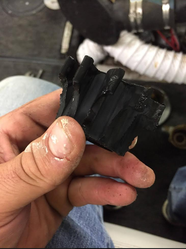

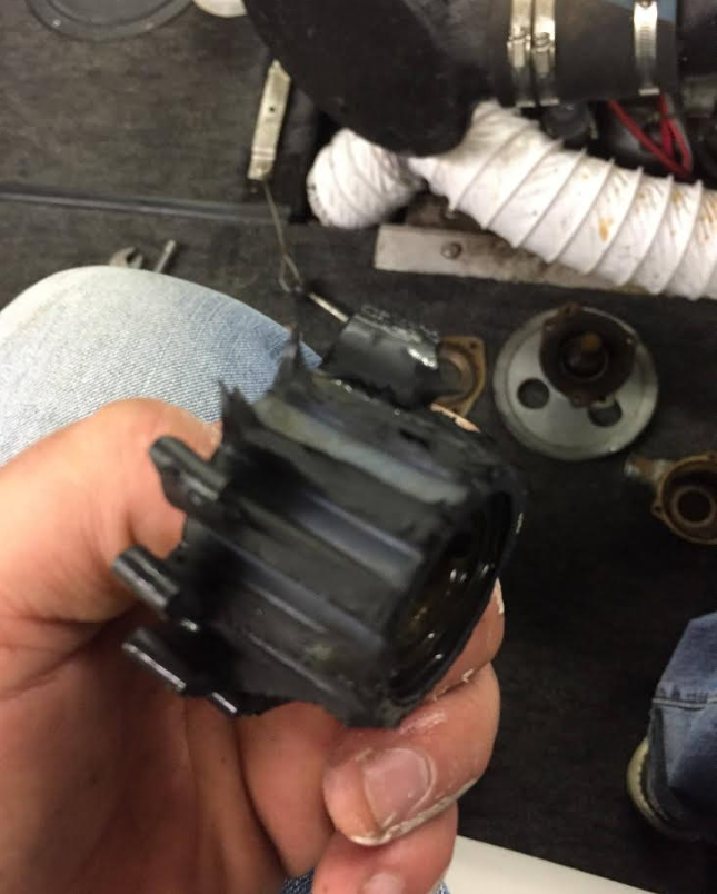

                                Thanks everybody on this thread! I just bought a 1990 Ski Nautique this past weekend, and this thread helped me diagnose the impeller as faulty. Boat starts easy and idles great, but would heat up to about 180 F really fast. Would then slowly climb to about 200 while idling. As soon as I get moving the temp would start to drop to around 160. This thread convinced me to order a new impeller, and last night I took apart the old one. Safe to say I found the culprit.
                                My question now, besides checking lines, should I open up the risers to check for chunks? I checked all lines on the vacuum side of the RWP and they didnt have much, but the line directly on the other side had quite a bit. Thanks in advance.
