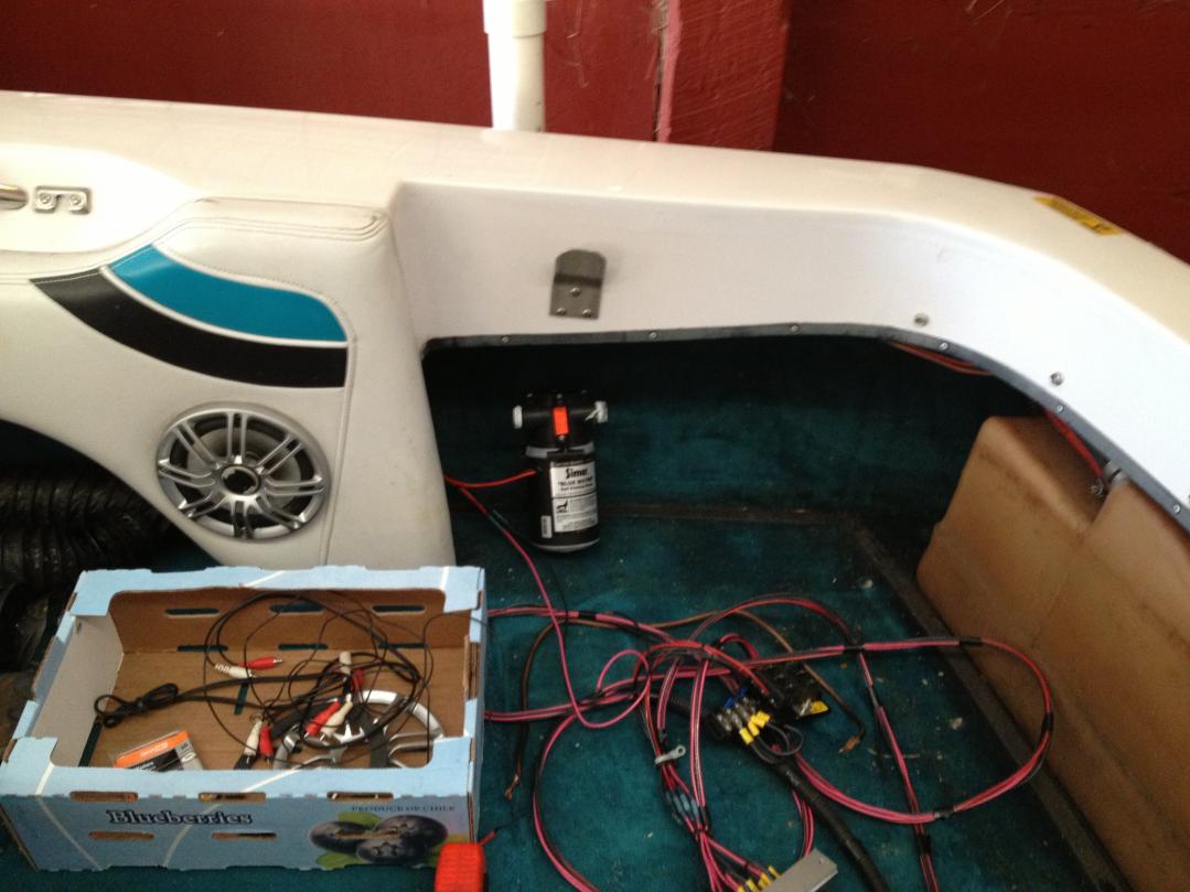

    Where are you planning to mount the pumps? I am not sure which model Simers you are looking at but I don't think their pumps are ignition protected like the Johnsons and Jabscos are so you might be limited as to where you can mount them because they can't be near potential gas fumes.

      Regarding pump placement, I am going to place the pumps under the gunnels towards the rear on the sides where the upper seat cushion covers. There's some room on either side, and there shouldnt be a problem regarding ignition protection, as, even though they are near the gas tank, they are in open air, and gas fumes sink to the bilge, not spread out under the gunnels. Also planning on making a vertical barrier on the mounting plate between the pumps and the gas tank to further "separate" the two.

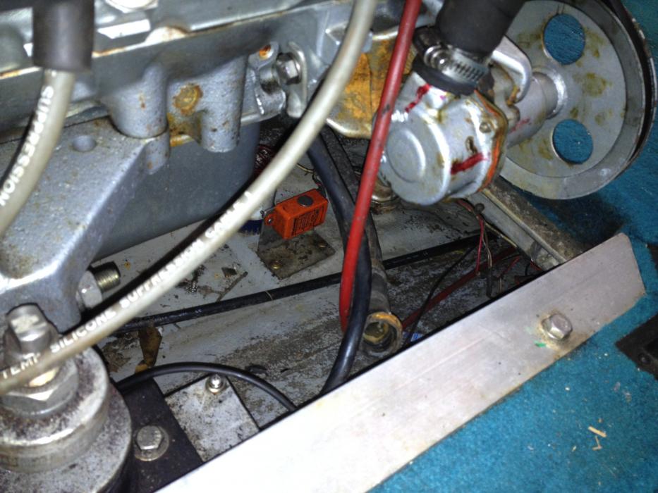

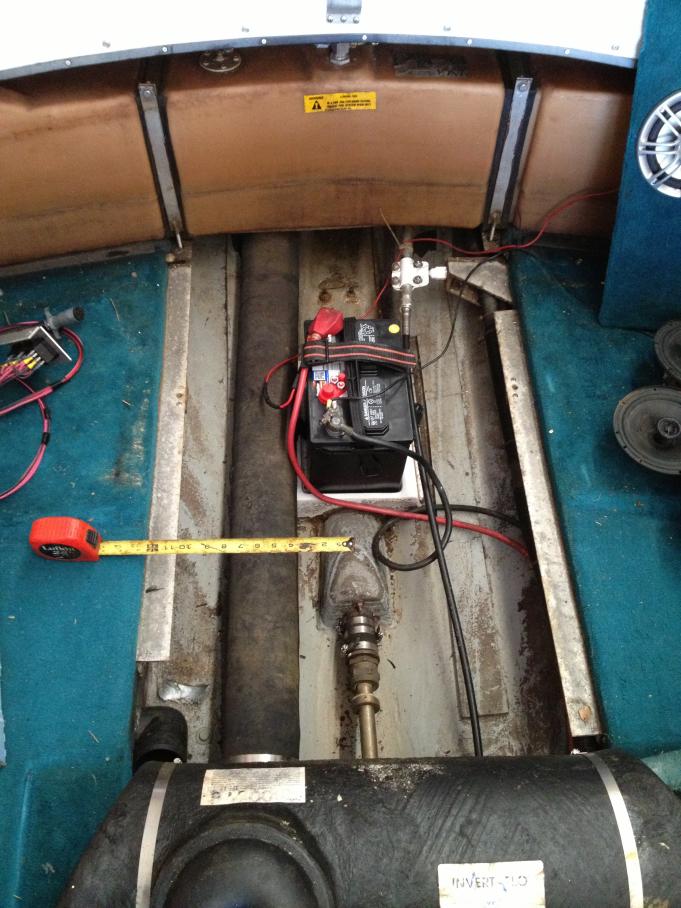

          I have include 3 photos: one showing the area in the forward bilge where there may be room for a larger thru hull or 2 smaller ones, the area on the starbord rear side under the gunnel where I plan to have 2 pumps (one pump will go on the other side, and a pump will go in the ski-locker). The other photo shows the rear bilge and the fact that there is almost no room to put a thru hull. 9" on either side of the drife shaft port lands me smack dab in the middle of a trailer bunk.

                    Well, if the 1" lines have air in them, it is limited to whatever is in them, because no air should be coming in from the lake when filling. I have check valves on the vent lines, so no air should be coming from there when emptying. All I know is that they work, and I never notice air going into the bags. They also compress down really tight when emptying thanks to the check valves. I think I have see-through lines, so I will take a look this weekend, but I don't recall seeing any air bubbles.
                    The 3/4" ball valves and elbows are pretty small. There should be room up there.
                    Personally, I think the distance of the pump heads (above the water line) is significantly more important than the length of any hose that is below the waterline. Ultimately, the time differential due to hose drag is going to be so insignificant that you will never notice it. I would go with what (a) fits better and if possible (b) is less expensive and lighter.
                    You have to remember that you also hve to get wrenches in here to tighten the elbow and the ball valve. Also, if you are worried about inside diameter, go thru-hull --> 90 elbow --> low profile brass nipple (rather than a street elbow) --> ball valve. You lose some inside diameter on the street elbows, but they are stronger, cheaper, and take up less space.

                      I've got a 97 sport, so same hull and configuration to yours. I plumbed in an auto ballast system, side sacs either side of the engine and a sac in the ski locker. I am running just one jabsco reversible pump, I have no problem waiting ten minutes or so for the sacs to fill and normally fill whilst on the move to where we board. Initially I tee'd the jabsco off the raw water intake, which was fine until I managed to stare the idling engine as the raw water pump impeller had taken a set over the winter and was not pumping efficiently. I have now placed a dedicated 3/4 Intake on the opposite side of the hull from the raw water intake. I have a 3 way manifold under the ski locker hatch so easily accessible from the drivers seat. The 3 way manifold allows me to open or close the 3 valves as I pleas, I haven't quite got round to adding a vent for the sac in the locker, on the list for this year. I was a little concerned about hose length, running from a pump behind the engine, up to the manifold at the ski locker, then back down the gunnels to the rear sacs, but to be honest I have had no problems. So, simple install, only one pump and flexible filling. Hope that helps.

                        Interesting battery location. I've always thought about using that space to add some additional ballast but havent put any thought into how to effectively secure it. Presently I have small bags full of lead (around 10kg per bag) under and behind the back seat, on top of the fuel cell, and where you have placed your pump. This has given my around 180kg hidden ballast but I have lost some of the useable storage under the seats that I would like to get back. Maybe another little project...

                          If I could get away with some permanent weight, I would; however, I keep the boat on a lift so all ballast needs to be out when I put it away at the end of the day.
                          Also, I'd be happy with an intake opposite the raw water intake but I couldn't reach a valve there in the event of an emergency. If I do just one intake there it'll likely be a 1.25 or 1.5" with a 90 hose barb and I'll take my chances that nothing goes wrong.
                          Regarding the battery location, I'm starting to dislike it because it is going to make running power for amps and ballast power tough/expensive. I need 20' of 4 awg power and ground wire.
