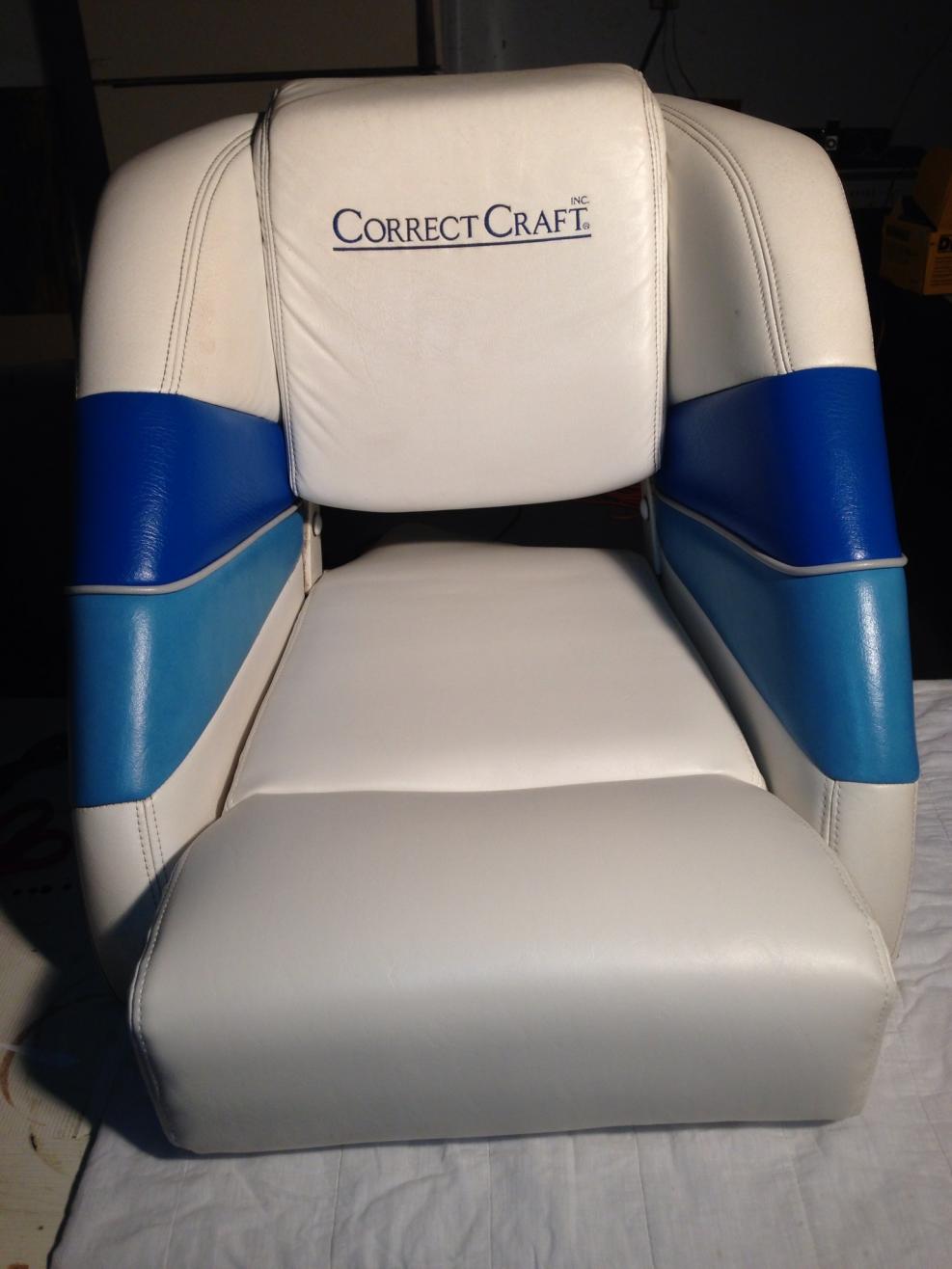

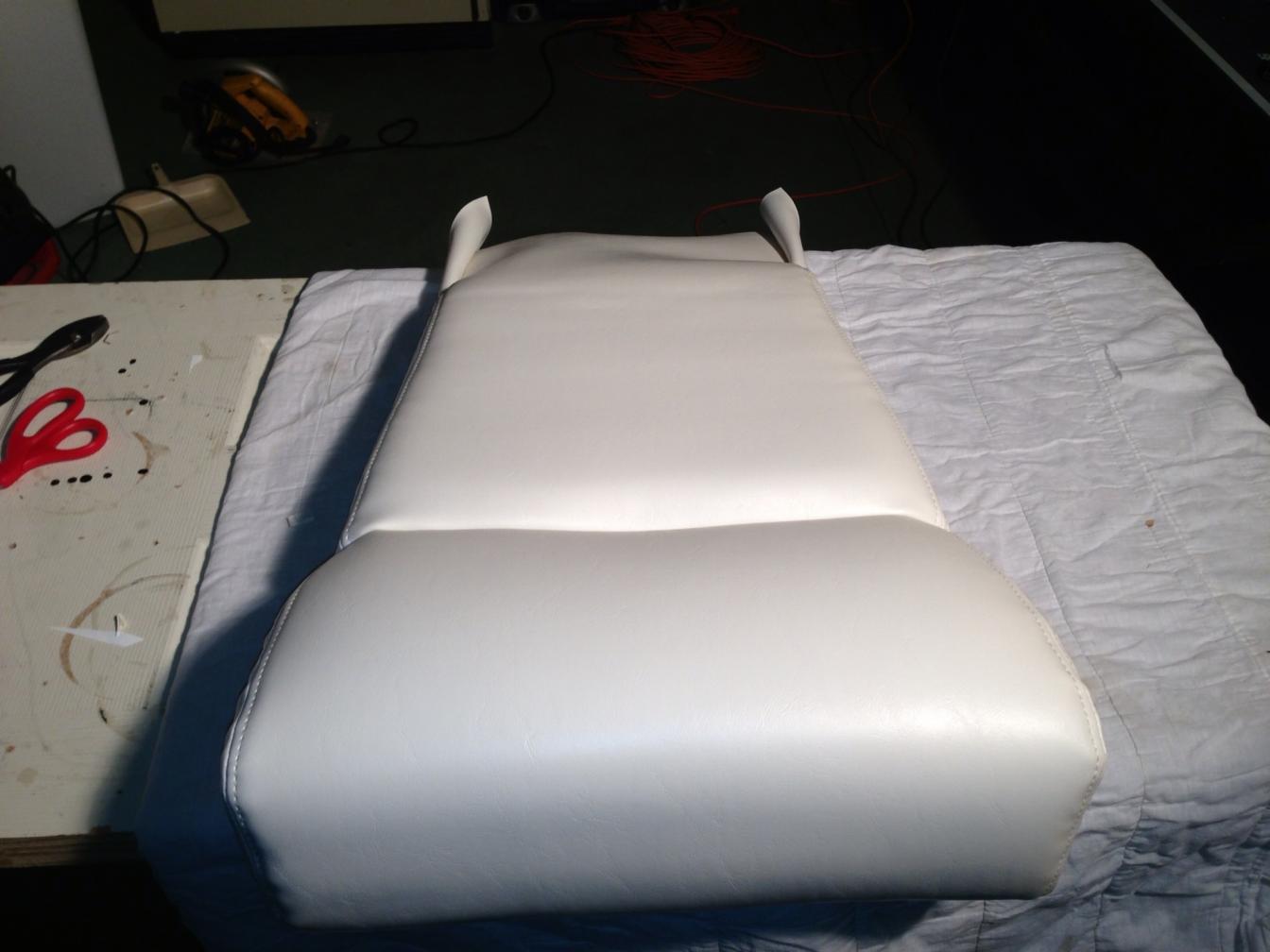

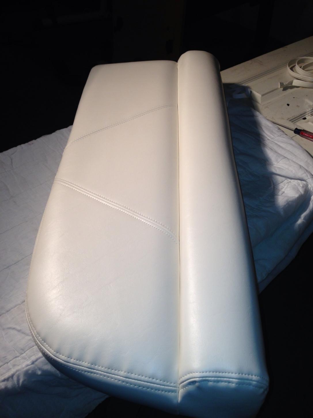

      I just redid 4 seats on two different skiers within the last few weeks. I was going to order my new skins from Christine's and when they said best delivery was 6-8 weeks rough guess I searched for a different place to they them. I called Zach over at N3 Boatworks in Indy and ordered them through N3. Shipped my old skins to there other upholstery shop in Indiana and I had the new skins in a week. Make sure to order the plastic film cover to install over the new foam for ease when pulling the new vinyl over and the bottom mesh covering to replace the old with new. Be patient and make sure to take your time when installing the new skins. If you need to get any custom nautique graphics in the new skins I would go to Christine's and no other. If the seats are just bottoms and don't have the embroidery then N3 s guy is good. Match was perfect for a 90 skier and 2000 skier. If you want I'll send some pictures. Take a lot of pictures as your take apart the old skins and remember the order for the foam sections as well. It will pay off.
