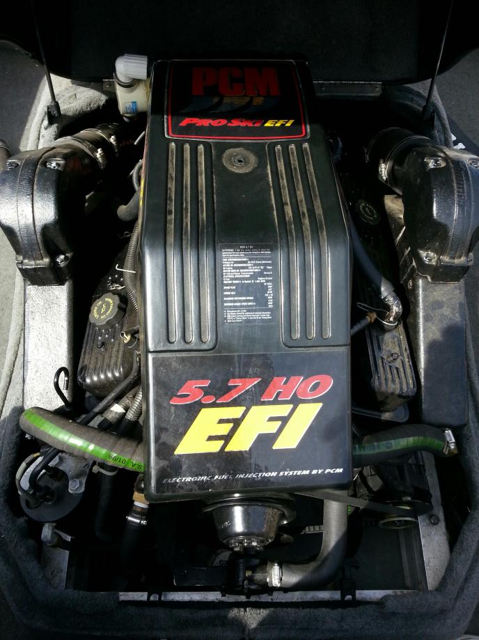

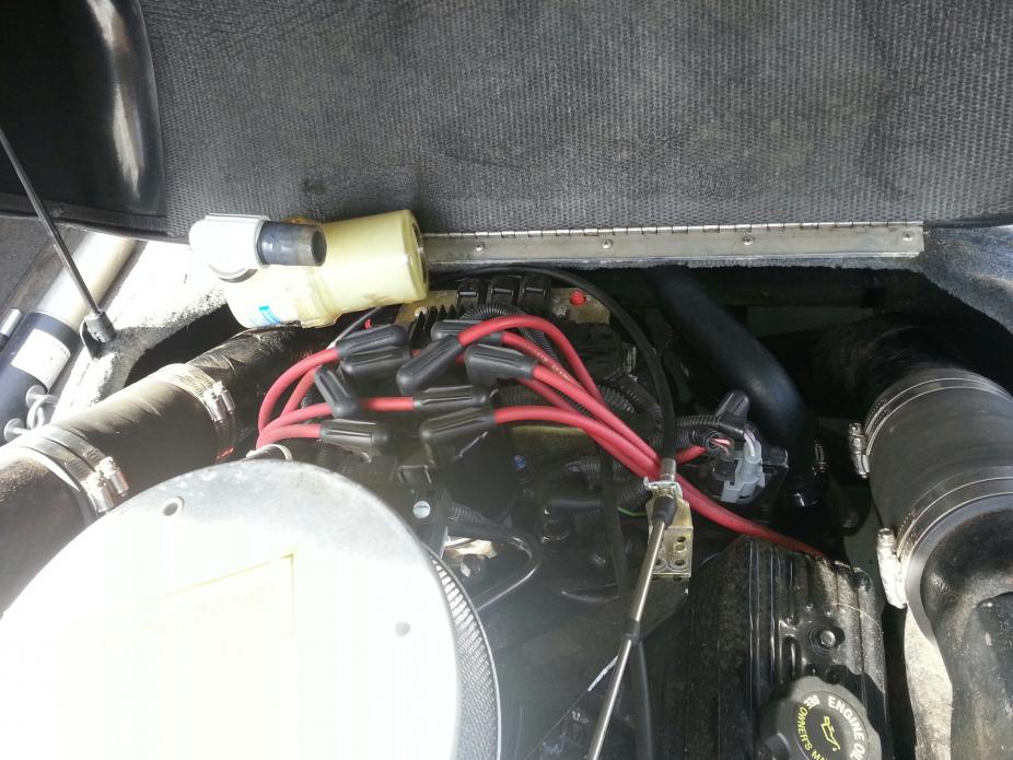

ID:	365654Click image for larger version

                The 96 Proski engine was a 275HP 350 Chev in 94-95 it was the the Ford Based 351 with PCM Throttle Body fuel Injection (TBI).
                If the screw on filter you are talking about is the one in your second picture. That is the RAW water strainer that is connected on one side to the water pickup on the bottom of the hull. The other side then normally connects to the transmission cooler. Not sure of the location of the cooler on the 96 Pro Ski. It looks like a big tube with hydraulic lines that run back to the transmission. Take some pictures and we can more than likely point you in the right direction.

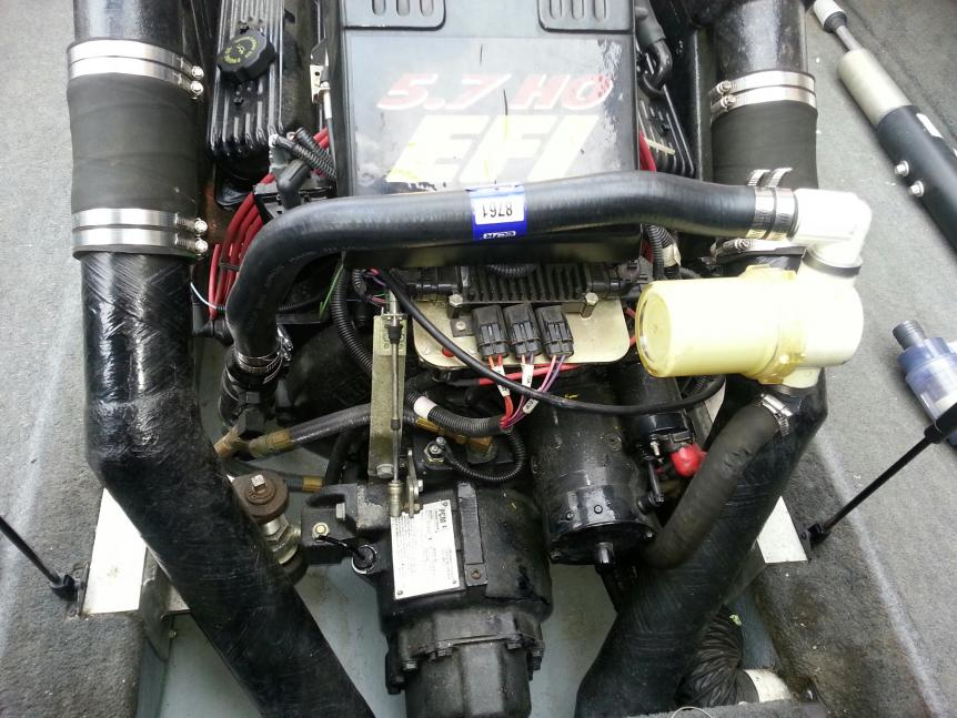

                              This is the only way I can get the hood closed, assume this will work, or may even be how it's supposed to be?
