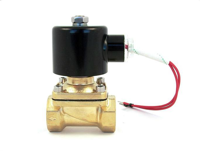

I've read the 23 page thread on this, and purchased the red hats. Is there a specific DIY writeup on this? I'm not certain on the best place to install them (my brass valves leak in addition to the flow-wrongs) and exactly how to wire them. Any help is greatly appreciated.
Wow, that's the solution that I came up with years ago. Haven't heard reference to it in forever, but it was a GREAT fix for the problem. You will be very happy with the results.
Just wire them so that the valves open when the pumps are turned on, and close when they are off. I just spliced them into the power wires for the pumps. Worked great. Mine were fairly close to the through-hulls, but they can go anywhere on the input line.Please do not PM me directly asking for advice on how to repair your boat. While I would love to help everyone, I simply do not have time to respond to all of the inquiries. Please post your questions on the forum, so that all of our members have a chance to answer.
I got all three for $150 total, I did see the cheaper option after I bought the first two though. Hopefully the install goes well, and the issue gets fixed.Originally posted by thedude View PostReturn the valves (unless you got them for real cheap) and get Johnson Impeller pumps. Those valves were expensive last time I checked, about the same price as an impeller pump.
not sure what one of those pumps go for these days, but i got all three valves for $125 back when i did it.Originally posted by thedude View PostThose valves were expensive last time I checked, about the same price as an impeller pump.
you'll need the 12V DC valves, not 120V AC.Originally posted by Tpmc View PostHey Jeff,
Was there a trick to getting the 120vac valves to work? I thought I read where yours worked, I can't get mine to open unless they get 120.

Originally posted by brhanley View PostDo you mind posting exactly the valve you purchased?
can be obtained at http://stores.ebay.com/valves4projects
will be fine, just keep your wiring up off of the floor of the bilgeOriginally posted by brhanley View PostAre the valves safe with water exposure in the ski locker?2003 SANTE - "OG 210"
Great, thanks. I assume you screw in a fitting with a nipple on either end. I think my hoses are 1" so I should get the 1" valve I guess. I hope the voltage works. This could be a sanity saver in my ski locker...hate I have to move the seat to open-close.
Hi all, I've been following this thread with interest as I have an 04 SV-211 with the TH valves fitted which I shipped to OZ last year. I'm wanting to change them over to the electric version as noted above. What size valve should I be ordering? The TH valves are 1/2" so should the electric valve be 1/2" with male hose fitting? Or should I get 3/4" electric valve with 1/2" hose fitting? Does 1/2" restrict flow? Thanks in advance.Last edited by dwelsh; 03-24-2013, 09:14 AM.
Thanks for the response, they are indeed 3/4" ID hoses used on the ballast system so I've ordered the 3/4" valves.
