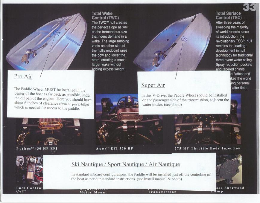

I installed a Stargazer in my 99 SS but should have gone with good old paddle wheel as I ski on a river. Time to drill a hole in my boat! Folks at PP sent me this!
I put mine in front of my water intake on the passenger side as shown in the first post. The other water intake is for my ballast.
