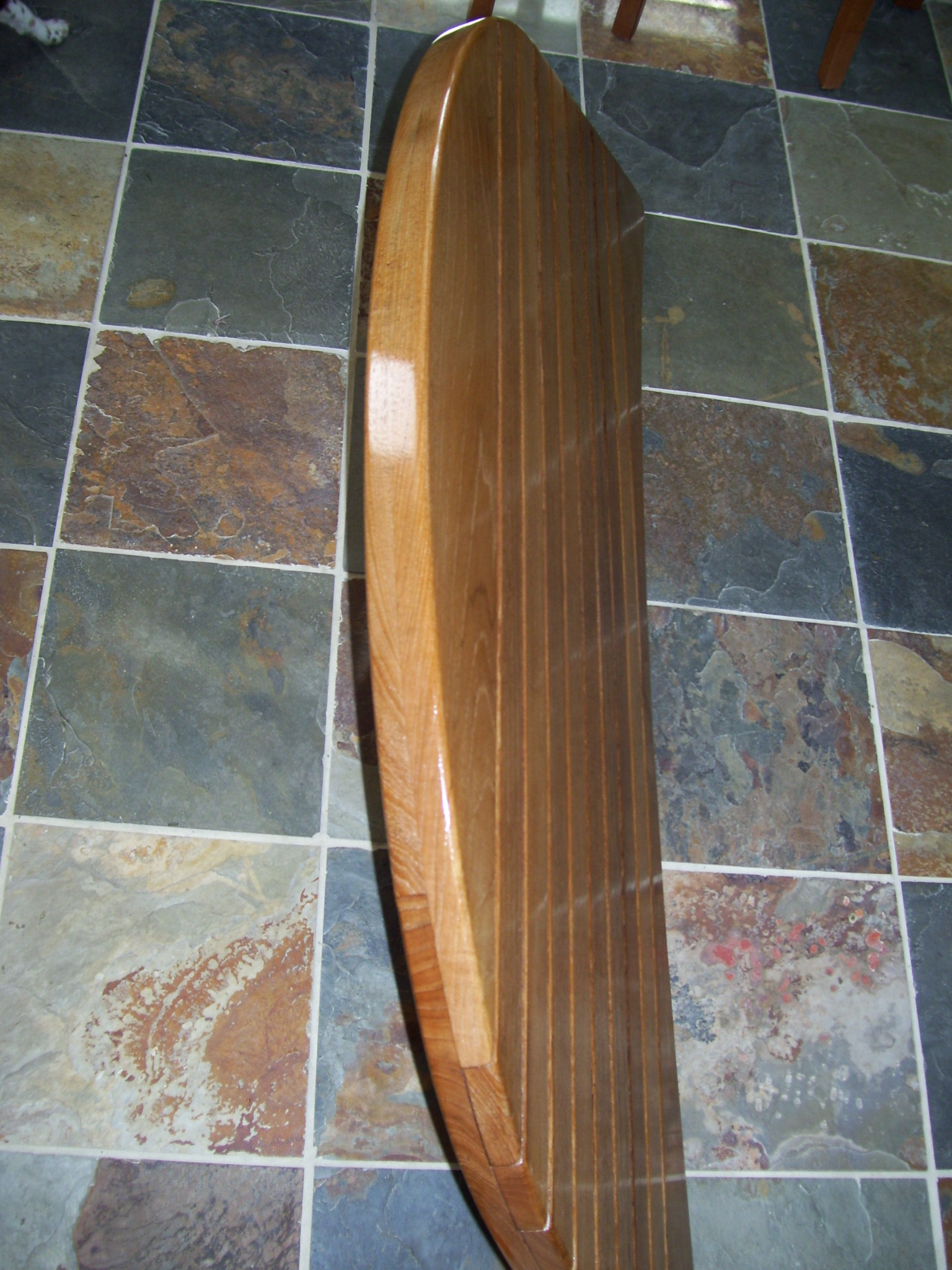

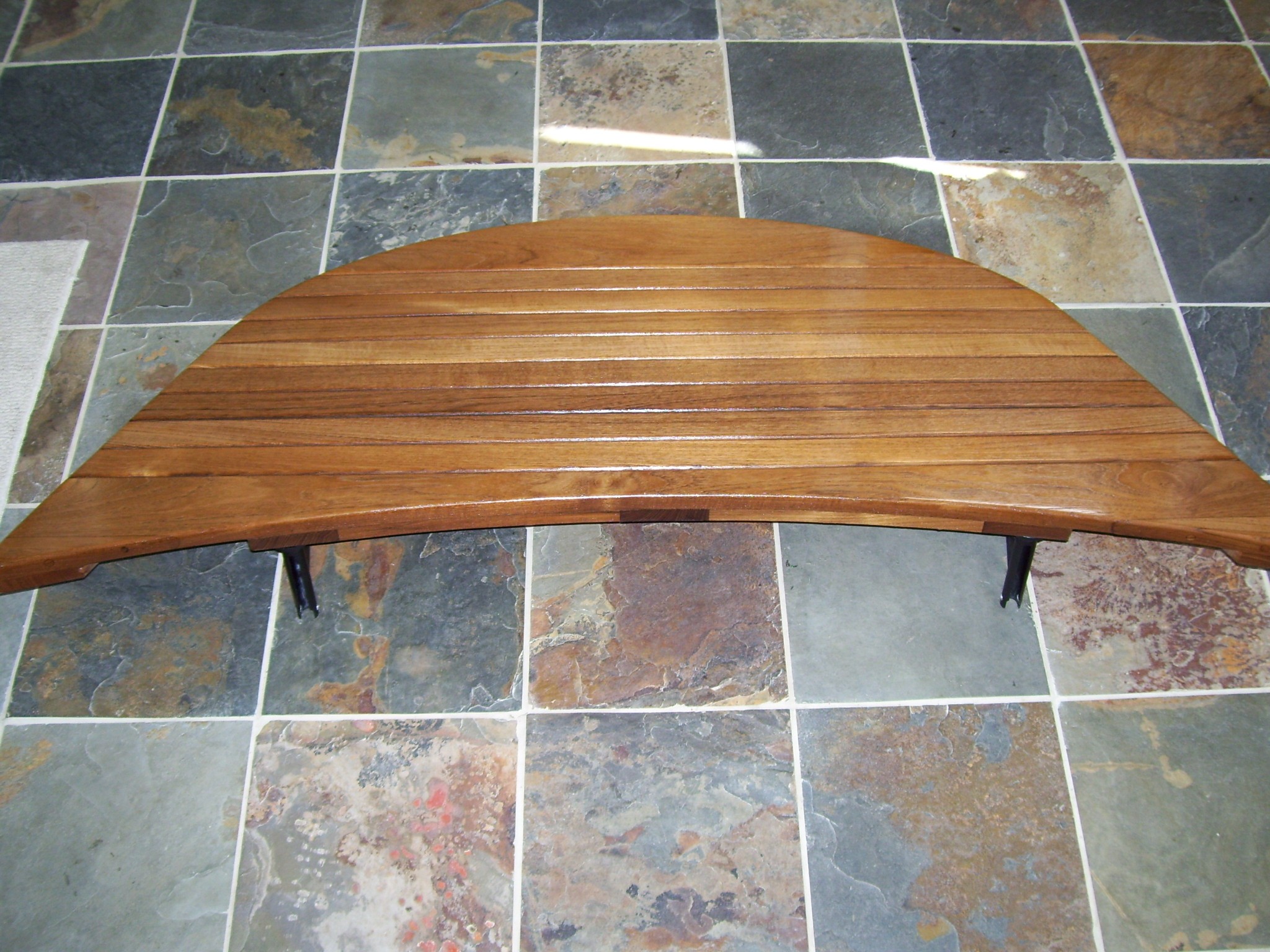

        Being that we have long winters here in WI, I had plenty of time to slowly oil my platform. Here's my method, and I know it'll be considered overkill by some. Obviously clean the platform and give it ample time to dry. You may want to dry sand your platform, if it's not smooth or has flaws you want to take out. The grit will depend on how beat up the wood is of course. Next: Apply a layer of oil to the top and sides; let dry. Flip and oil the bottom; let dry. Once dry, wet sand lightly with 1000 or 1200 grit. Let dry, and repeat each week until the wood is thoroughly penetrated with oil - basically it stops absorbing oil. You'll easily make it through an entire summer with a beautiful oiled platform. I'll try to post some pics of mine...
ID:	365444Click image for larger version

              Wow, THAT's an oiled teak deck! Did you use any source of heat between oil coats? The "old salts" recommend doing it in the sun so the wood's grain opens up more...

                          @swc5150, that has to be the best looking teak platform I have seen...better than mine! Way to go! Have you noticed any oil residue on the bottom of your ski or board? That is the only reason that I have used oil fairly sparingly.

                              Every few years, I hit mine with about 120 grit and start from new. About 3 coats of Amazon golden teak oil, and it's looking great, and not to slick to use. As mentioned above, the wet sanding, fine piece of furniture method looks great, but is slick like glass. In between major resanding, I just hit it with a quick zero grade steel wool, dust it off, and apply a single coat of oil with the palm of my hand. Wipe off the excess with a rag and it's good to go for the next year. I spent about 15 minutes on it today. First picture is before I wiped off the excess.
