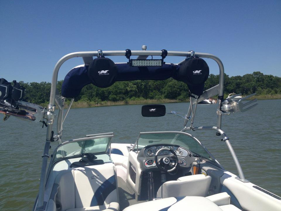

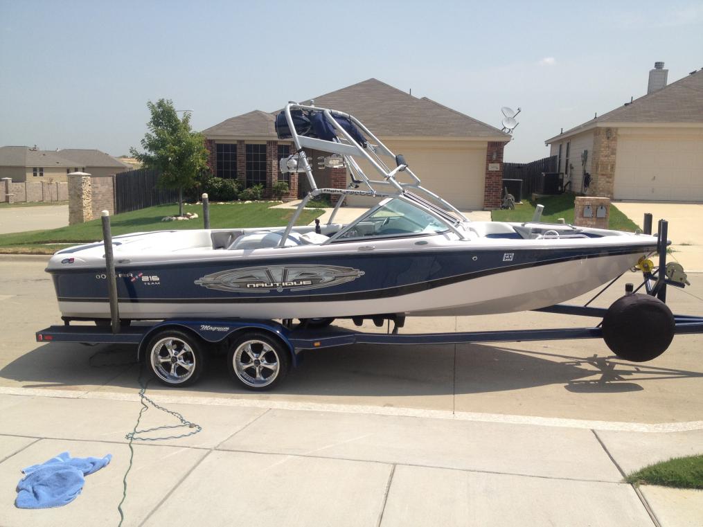

                  As mentioned above Spend some $$$ and you'll get all the enjoyment you can handle. I revamped my stereo system last winter with a budget in mind and installed:
                  Reused - Factory Head Unit
                  JL Audio 600.1 amp (Kicker 10" subwoofer)
                  JL Audio 600.6 amp (6 Rockford Fosgate Boat speakers)
                  Wet Sounds SYN4 (Pair of REV10's on the tower)
                  Wet Sounds WS420 Equalizer (a must have when using multiple amplifiers)
                  Although my head clearance is tight with the REV10's being mounted on the rear tube, IMO I thought it looked better. Regardless of where they're mounted they are just large speakers. Good luck in making your choice, there's lots out there.....
