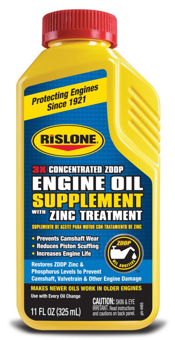

                              I use an oil treatment in all my engines that don't have a roller cam
                              Lawn mower
                              snowblower
                              classic car
                              ski boat
                              This may not be necessary with some of the synethics but its been working for me with the cheaper oils.

                                They are correct that the 10+ year old manual is outdated. I agree on their recommendation on the multiweight... but Im not crazy about the Rotella. They changed their formulation about 6-7 years ago when all of the increased diesel emission requirements came about. Zinc and phos were both reduced as a result... I believe 15w40 is in the 1000-1200 ppm range on both. I would say thats borderline acceptable for a flat tappet engine... Id opt for VR1 or M1 15w50, as both have 1200/1300.
