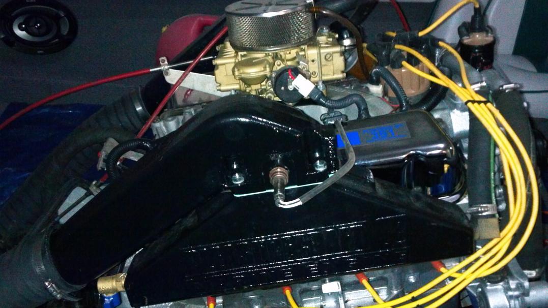

      Buy a brass ¾” NPT faucet valve from a Hardware store, Home Depot,Menards, Lowes or Fleet Farm. They costabout $6.00. Cut the end off with a hacksaw (see the attached pictures). Theonly thing that sucks about this, is you have to remove the riser to installit.
          [ATTACH=CONFIG]20268[/ATTACH]
          [ATTACH=CONFIG]20269[/ATTACH]
          Is that an O2 sensor in your riser or a wideband? Seems odd with the carb...

            Its an O2 sensor for a wideband air/fuel ratio gauge.
