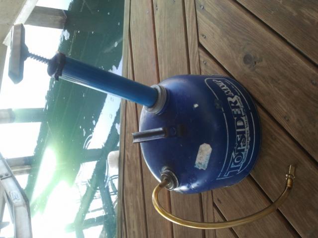

    I keep my boat on a boat lift cradle. For year I would raise the boat and slide a 2" x 12" board under the boat to hold a drip pan. I ran the oil pan drain hose thru the drain plug and had to make sure the pan was stable on the board.
    My Topsider oil pump is good for changing the tranny fluid but not so good for sucking oil thru the dipstick.
    I bought a brass fitting with a female threads on one end that matches the male threads on the pan drain hose. The other side of the fitting is a barbed connection that fits the 1/2" od dia vinyl hose on the Topsider pump. I cut a foot off the excess of the Topsider 1/2" hose and slid it on the barbed connection.
    Now I just screw the 1 ft hose and fitting on the oil pan hose and pump the oil out while sitting in the boat.

      Thanks Jay...several of us have built similar adapters. Here is the best one....it has a nut that spins. Much easier to attach when its already on the barbed hose. You can get a hex plug to match so it doesn't drip when not connected.

        We use a jabsco (electric) pump set up that screws onto the lower hose to pump the oil from the bottom of the pan. In my experience the dip stick style pumps were never worth a darn.

          yep, have the fitting on my "Suck-Up" and it works perfectly. I did the lake boat a couple months ago and the guys could not believe how easy and fast the oil change went. They timed me, it from lifting the doghouse to being complete it took 11 minutes total.
