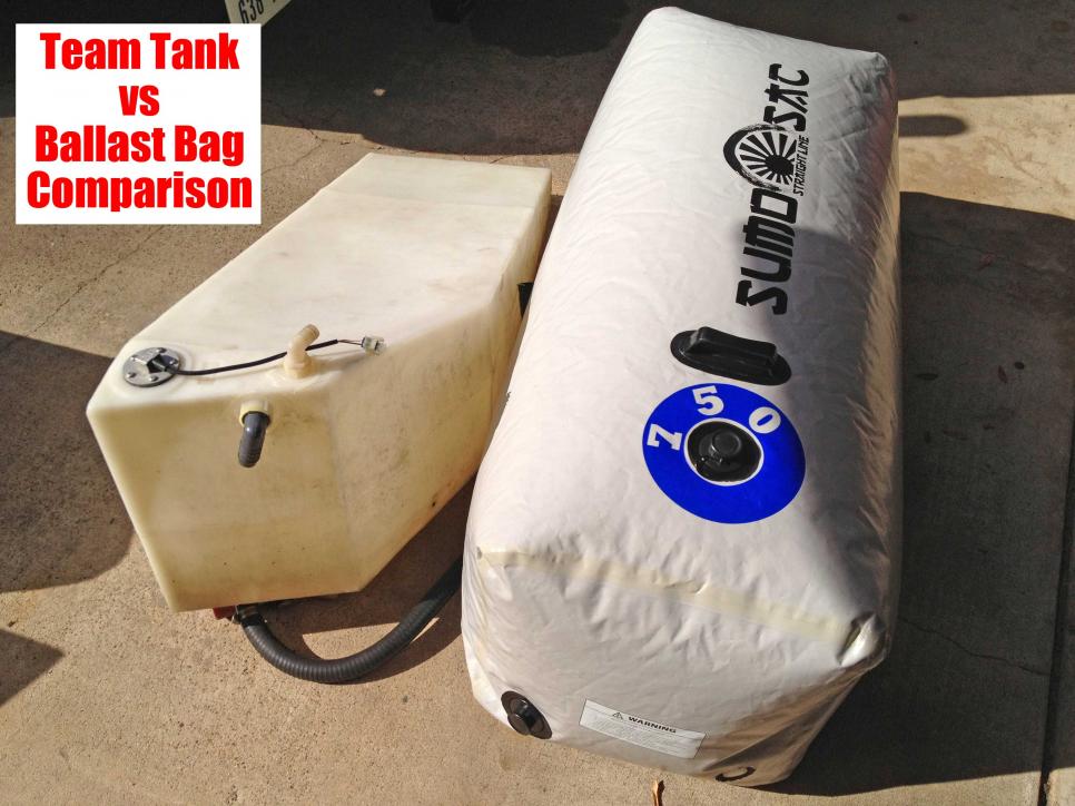

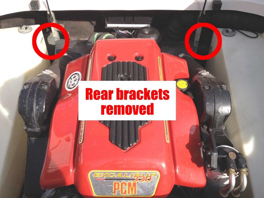

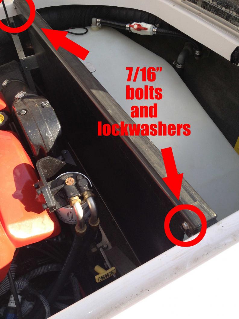

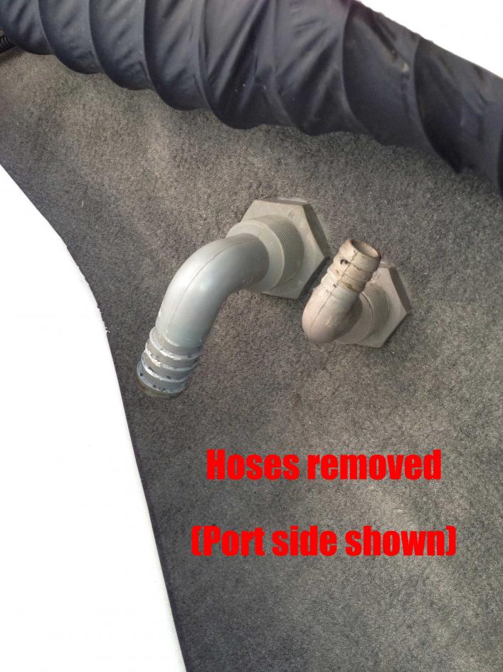

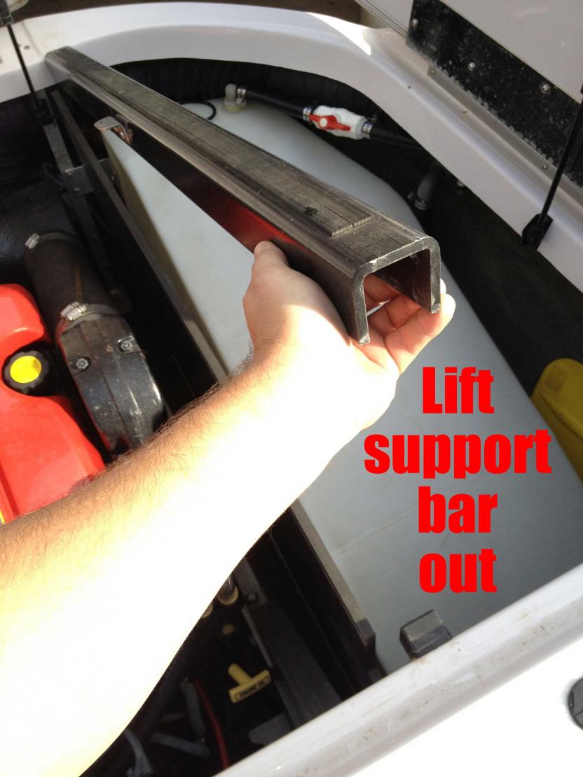

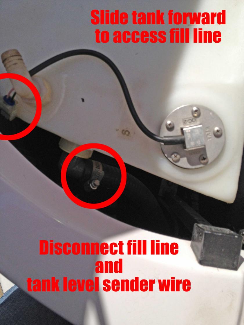

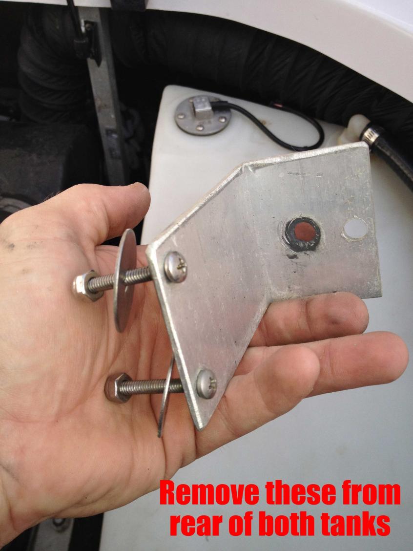

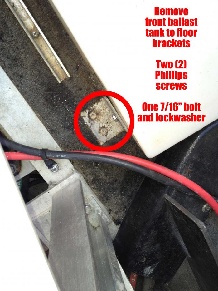

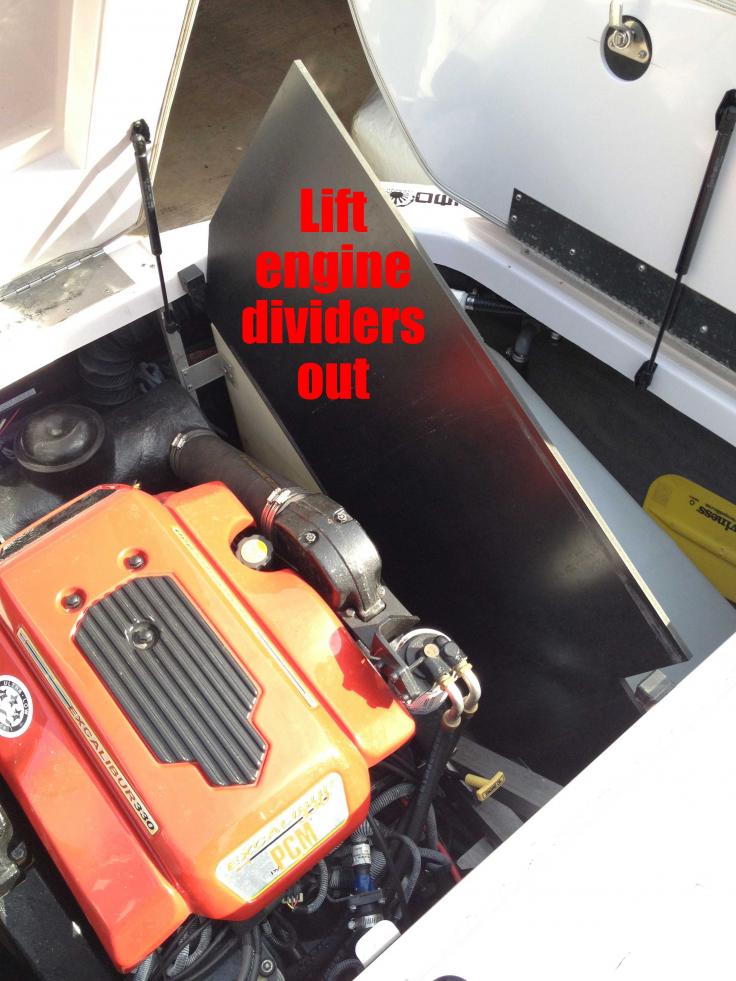

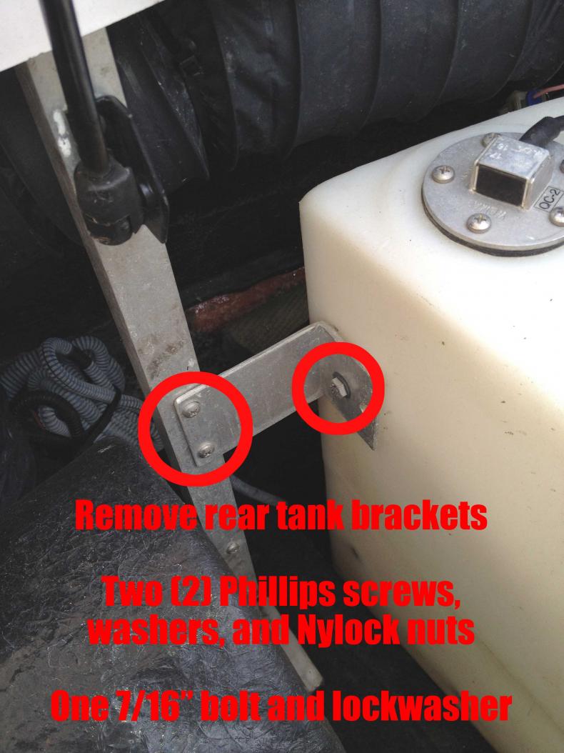

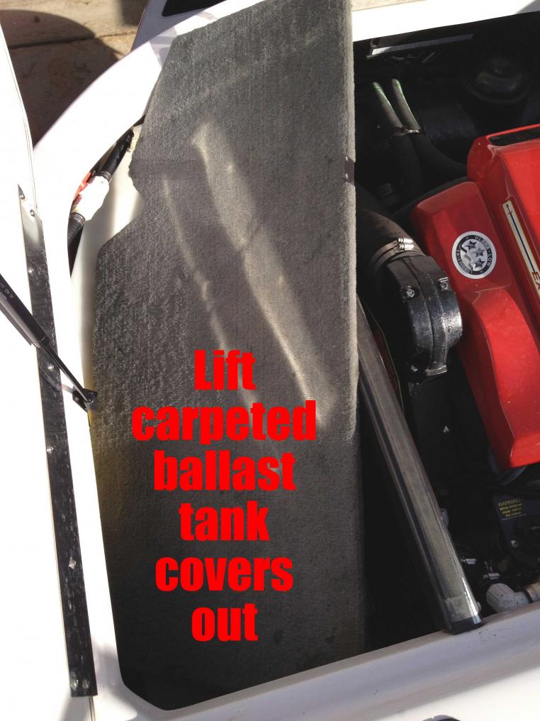

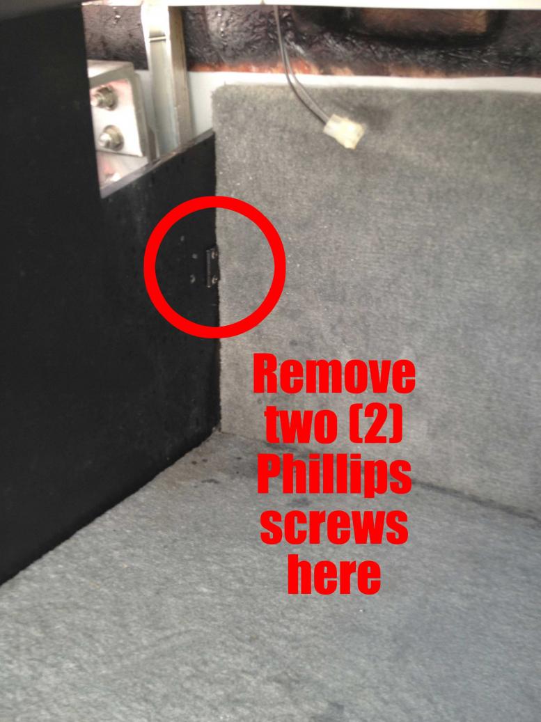

With the weather here in East Texas finally getting cold, I've decided to winterize the boat and start some of my winter projects. First on the project list - removing the rear wedge tanks and replacing them with bags. I took pictures along the way to help anyone who is thinking of doing the same.

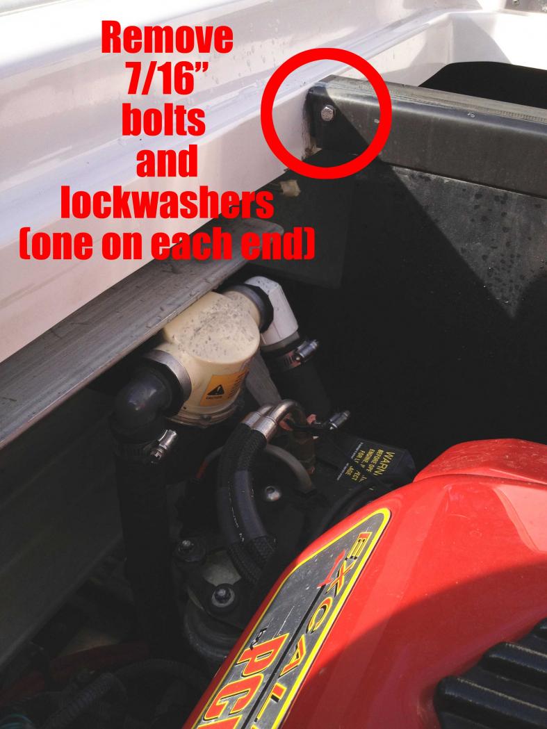

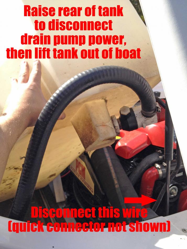

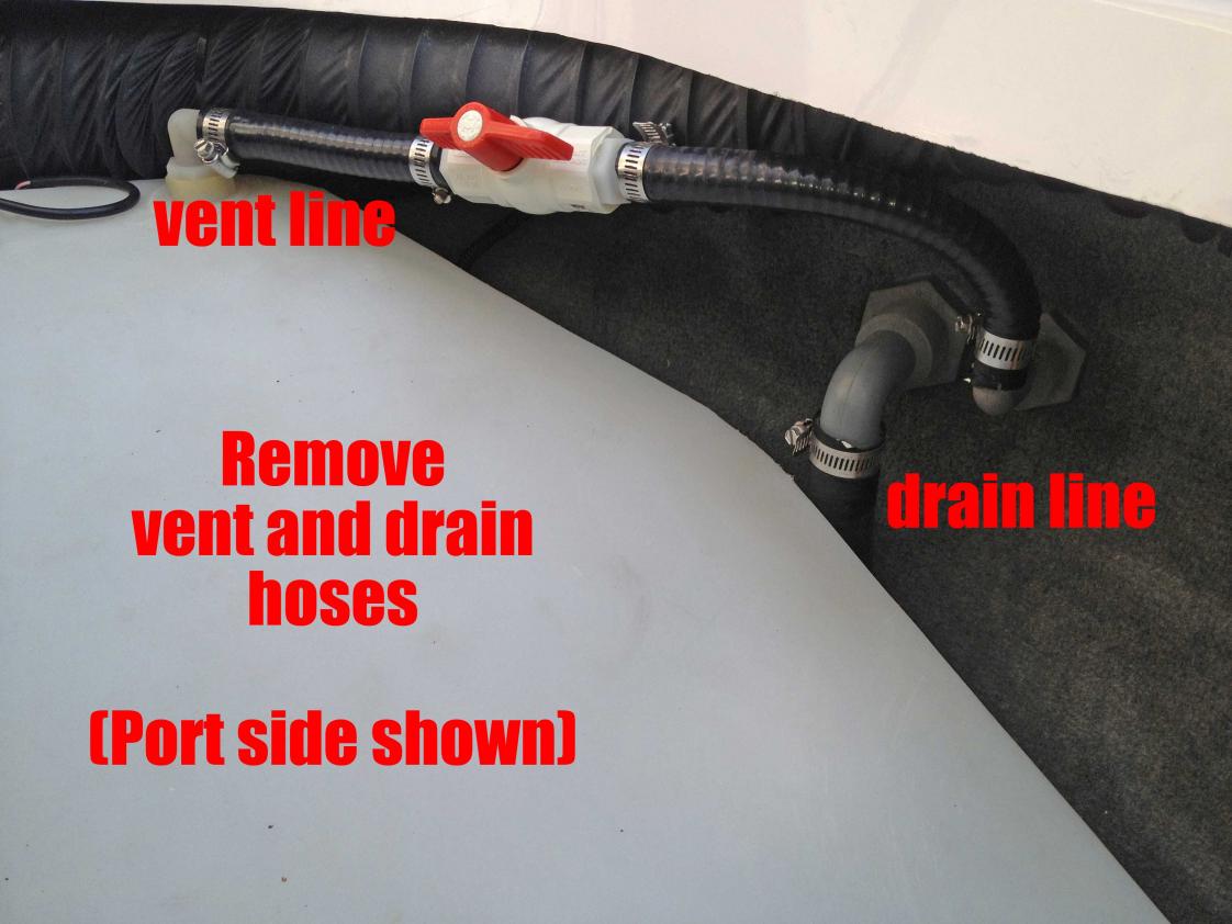

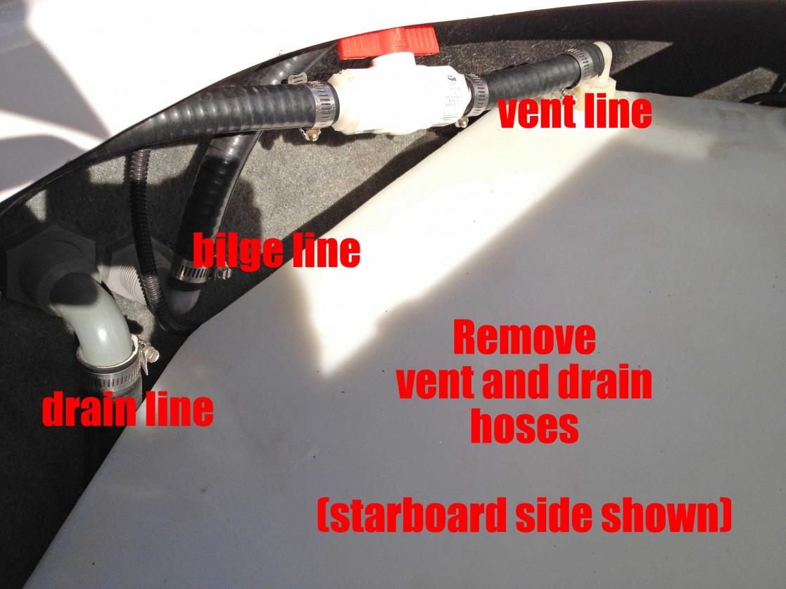

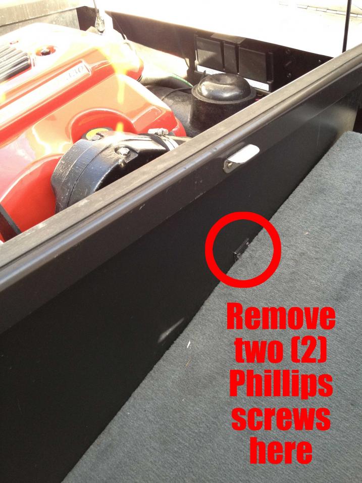

All together, it only took me about an hour. The worst part (by far) was removing the hoses from their barbed fittings, other than that the whole process was cake. The only tools required were a 7/16" wrench (or Crescent) and Phillips and flathead screwdrivers. It was N-A-S-T-Y under those tanks!
