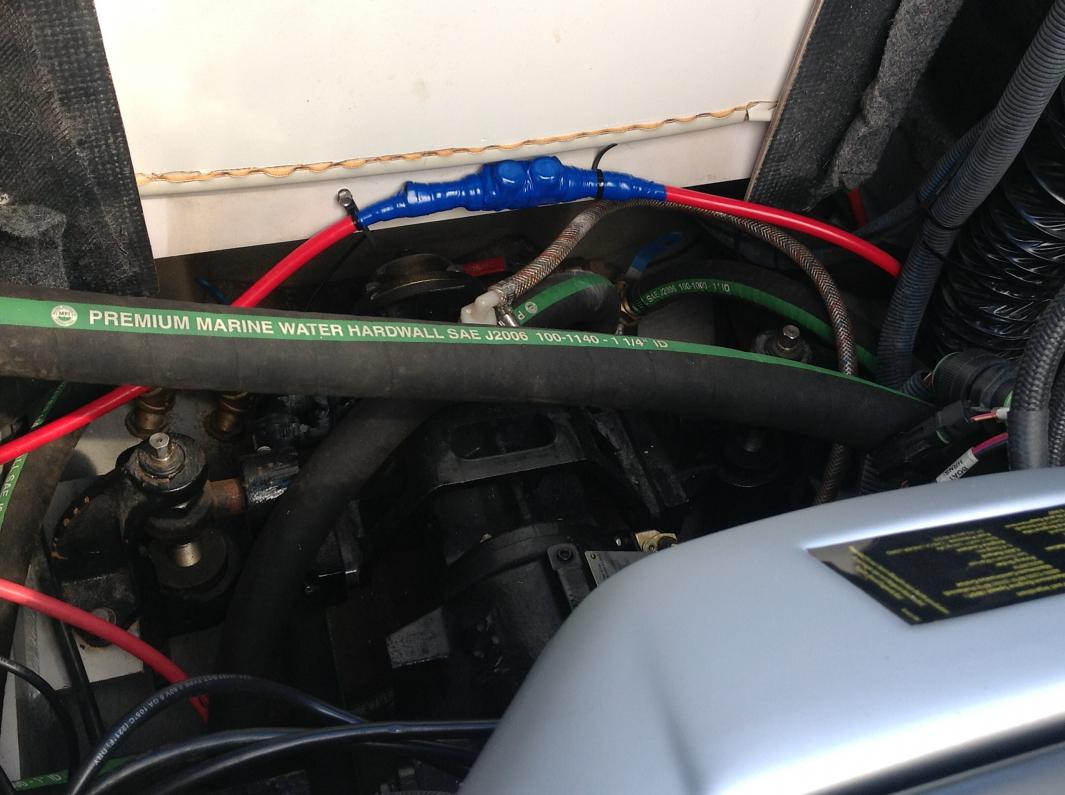

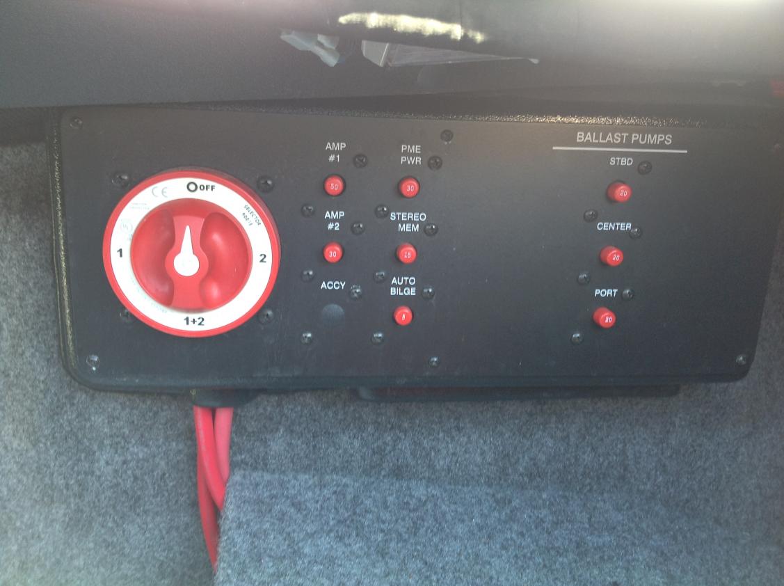

A few weeks ago during a storm on lake, I suddenly lost all power while underway. Switched to other battery circuit and was able to get home. Noticed the #2 ciruit wire was touching part of the engine as it crossed the bilge and was burnt through insulation. I cut out nearly a foot of wire then used butt splice and mounted out of the way. Still no juice - battery is still good. Is there a breaker somewhere? I cant tell that this panel does anything and nothing about it in manual. Any direction would be appreciated.
Sorry, this is '09 220. I guess it's better to say hello before asking questions. I bought this used last summer after cracked block was replaced.
