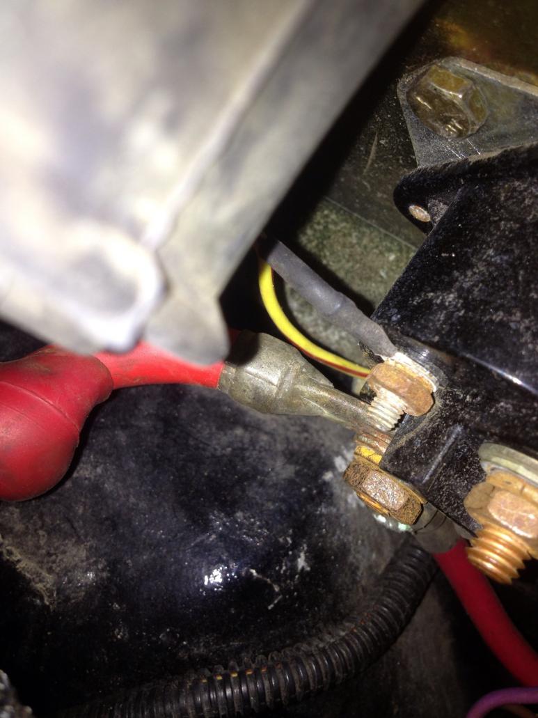

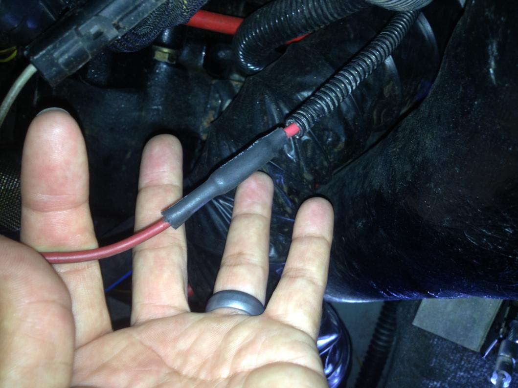

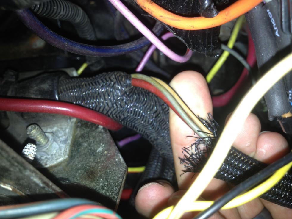

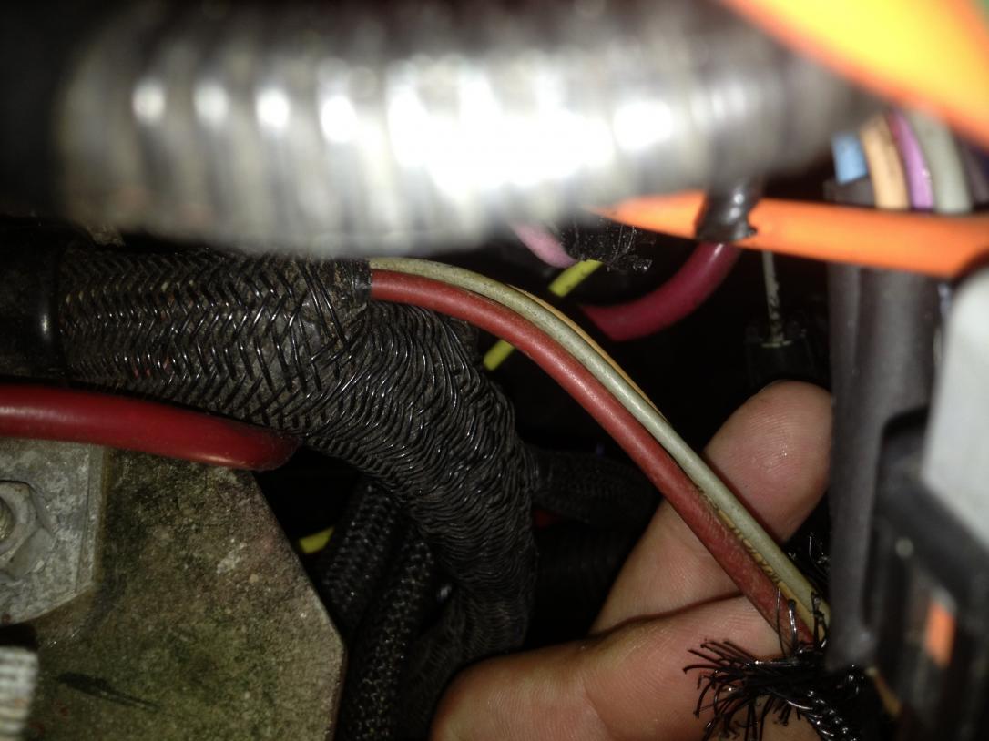

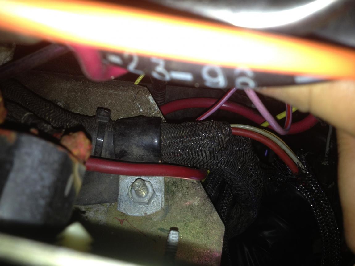

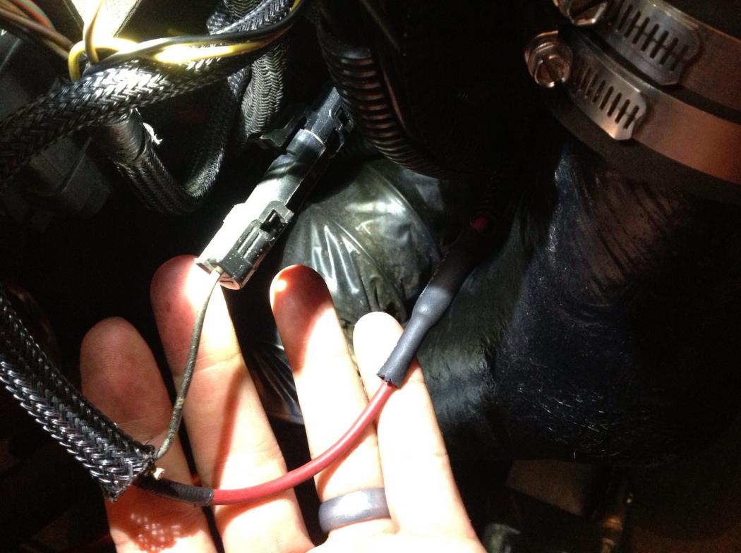

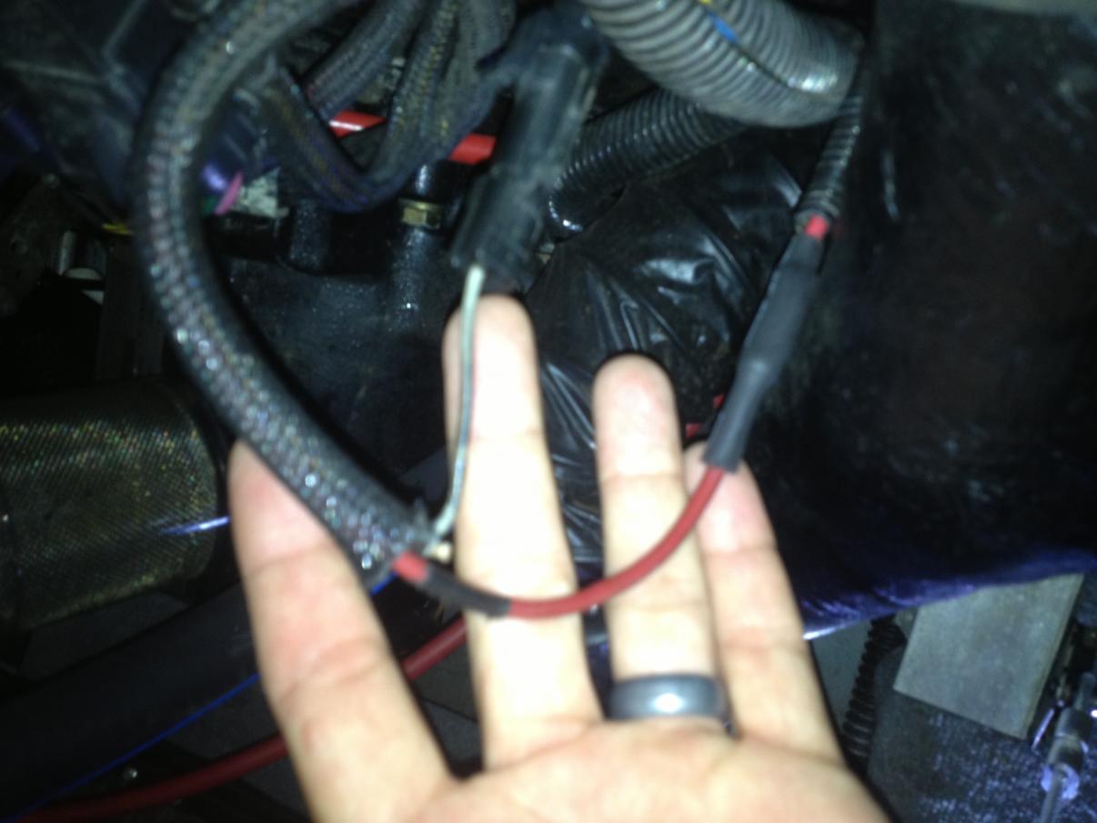

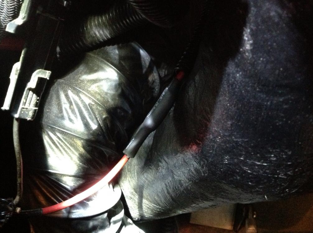

Ok. So after many hours of tracing wires and reading the manual. I found the problem. Relays were not getting any power because the 15 and 12.5 breakers were not getting any power. The power wire for those two was traced and it was found that the wire was cut at the end and was not connected to battery. So I ran the cable to battery and presto! I have power to the breakers,relay and the motor is now running! Thanks for replying to my post and for all the helpful suggestions!
I purchased the boat with the motor not running. Also, the red wire that leads from the battery box like the pictures to the link above did not lead to a waterproof connector with red on one side and purple on the other. I had no power at the 15 or 12 1/2 breakers. I found a solid purple wire with the round terminal but it was connected to the selonoid but it was not at the terminal where the main wire is connected to. I did try and remove the purple cable and connected it to the main power terminal at the selonoid and still had no power. That is when I decided in desperation to connect the cut end of the red wire to the battery to see what would happen and thats when I had power, spark and motor ran.
The post on the power assist solenoid that you connect the purple wire to is the main positive battery cable from the battery. Gives you the same result as the extra wire at battery terminal that you are using but has no joins in it plus is a much larger gauge. If you re connected the wire at battery box and the engine fired then the other end where it goes to the 12.5 amp breaker must have still been connected. Take some pictures of the battery box end and the wiring into 12.5 amp breaker. There is already a purple wire on power assist relay plus the one you add after doing the modification. The purple wire you cut and add a ring terminal to is at waterproof connector. There is red on one side from battery box and purple on the other side of this connector that goes into the shielded loom up to the 12.5 amp EEC power breaker.
The 15 amp breaker (early GT40's had a 20 amp) is for the fuel pumps it gets its power from the 60 amp breaker which in turn gets its voltage from the battery post on power assist solenoid. Have attached wiring diagram from GT40 manual.
Sounds like the waterproof fuse holder was removed but they left the wiring in place. Somebody has obviously been there before you which is confusing the matter.
