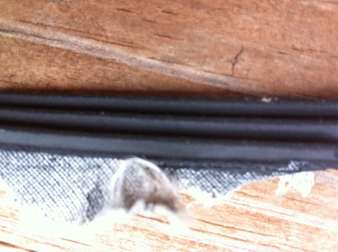

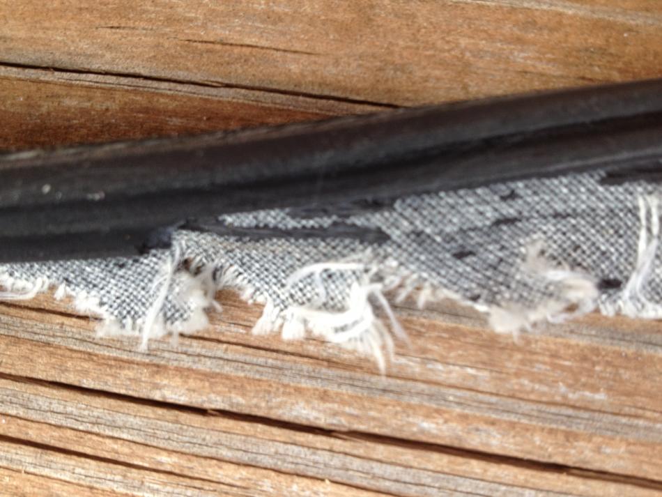

        I am trying to attach a couple of pics of what is left of the belt...does not seem overly dry to me - just looks like it came apart.Click image for larger version
ID:	364402Click image for larger version

          Ok, figured out what happened. Looks like one of the 3 bolts holding the water pump pulley failed (came off). Pulley starting wobbling and that shred the belt. Marina thinks the bolt was probably not tightened correctly at PCM - they never saw this failure before on a quasi-new boat. Everything covered in warranty: 2 new pulleys and belt. Should be back on the water next week-end!
