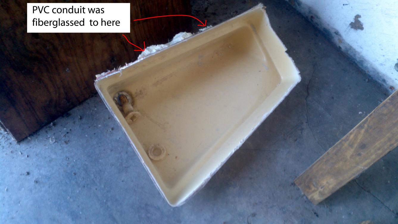

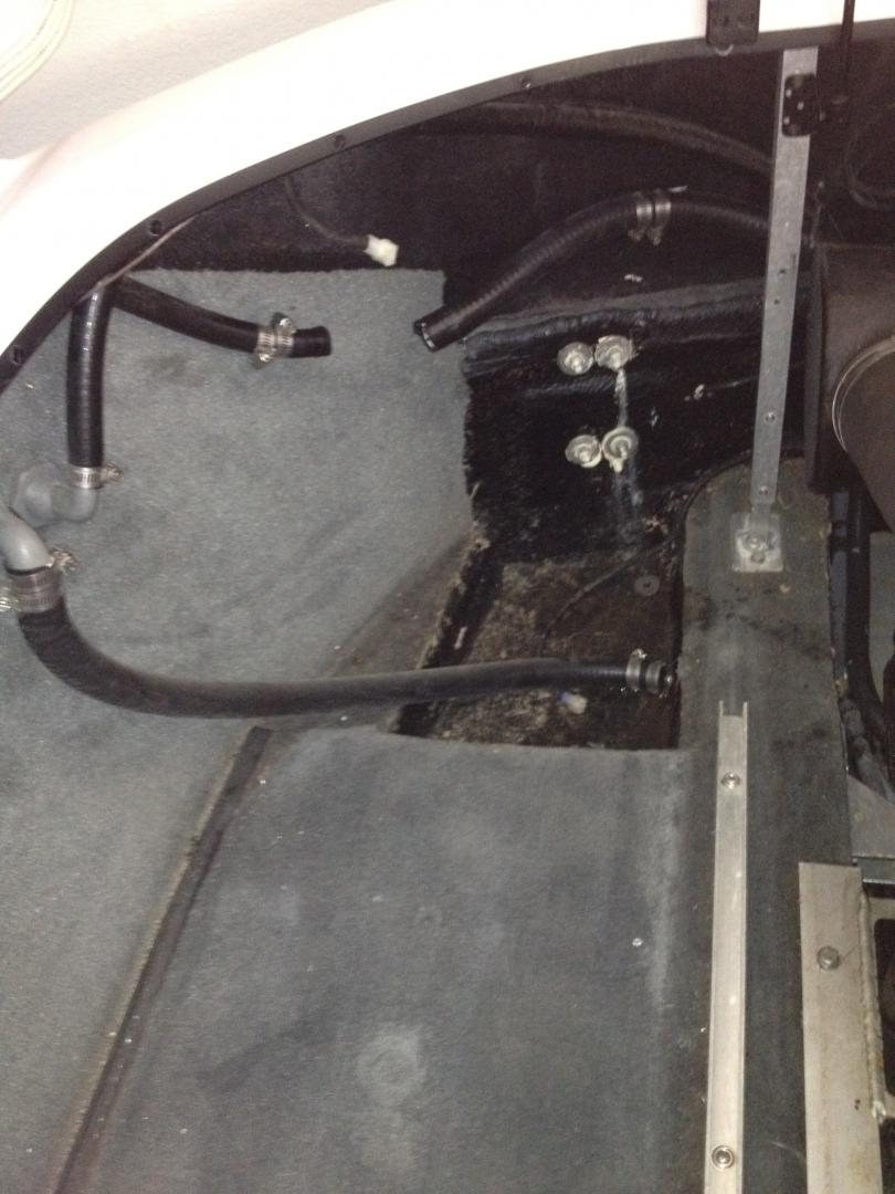

    I searched and couldn't find a post when I did mine a few months ago (2004 210).....

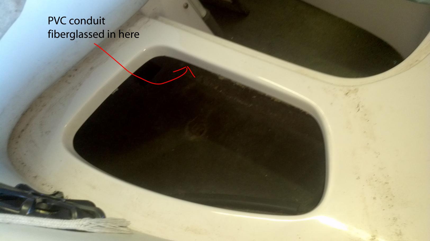

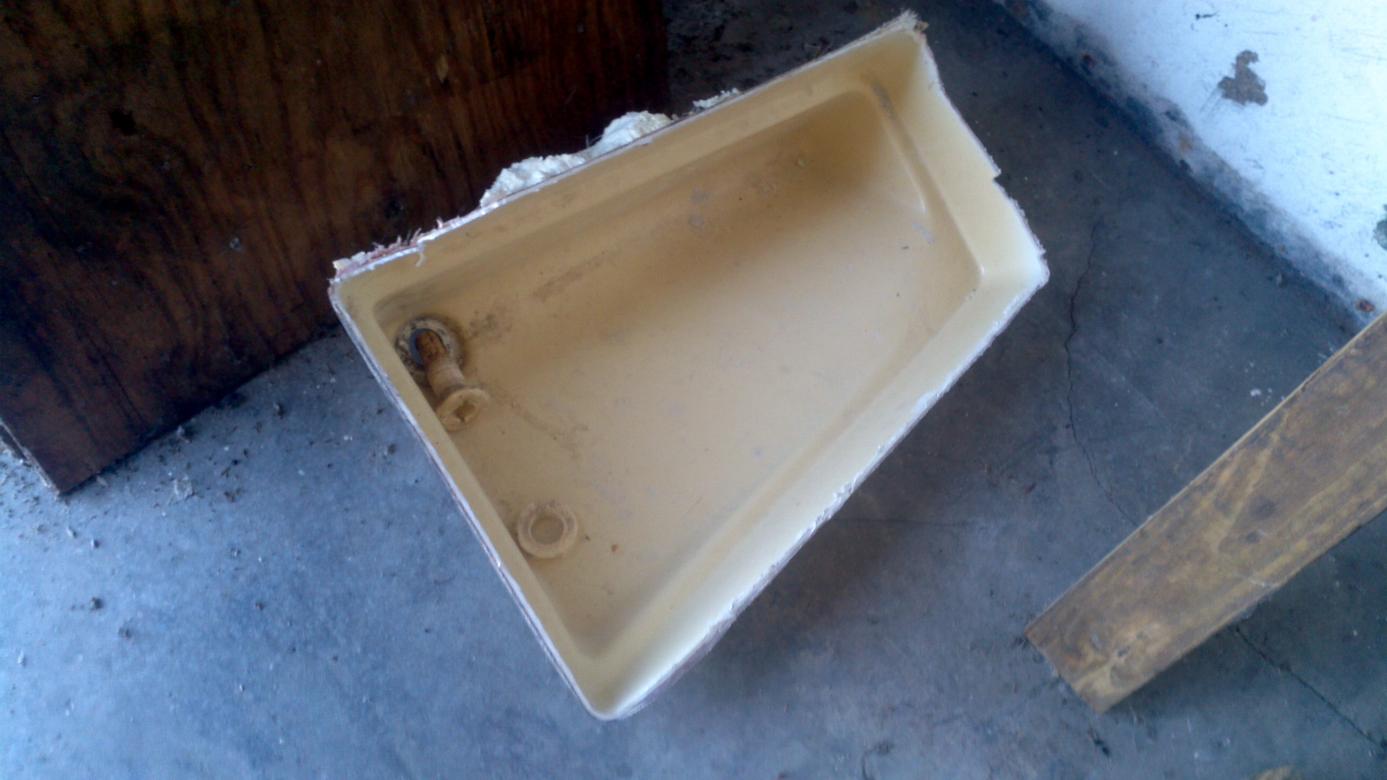

    I used an air-powered die grinder. It was no easy job, mostly because of the limited amount of space. I believe I started on the inside of the cooler with a cut-off wheel on the die grinder and tried to work my way around as much as I could and as high up as I could. The corners were the most difficult because the grinder wouldn't fit down inside of the cooler and the wheel I was using wasn't big enough in diameter to let me cut with the grinder above the cooler (does that make sense?). So I ended up with a smaller deburring bit on the grinder so that I could get the body of the grinder perpendicular to the cut. Once the cooler was rougly cut, I used a screw driver and my hands to remove as much of the foam insulation as I could and break the cooler free. Be aware that my boat had a PVC pipe conduit fiberglassed in high up on the inner-side of the cooler with some wires running through it. Then the cooler was still stuck, since the opening in the deck for the cooler is smaller than the cooler itself. I ended up removing the driver kick-panel and taking it through that opening (might want to plan on removing this before you start). After it was out, I had a lot of insulation left to remove and then I finished grinding what was left of the cooler off. Then got the shop-vac out and tried to clean up the dust.
    Not sure if that makes sense. It took longer and was more aggrivating than I thought it would be!

      I added some arrows showing where the PVC pipe conduit is located.....Click image for larger version

        Yeah... that makes perfect sense. The pictures help alot, thats what I was looking for. I wasn't sure about the cut on the inside where the seat filler cushion goes. Didn't want to cut all the way through if it was solid there or grind it up and make a mess. Thanks alot for the info.

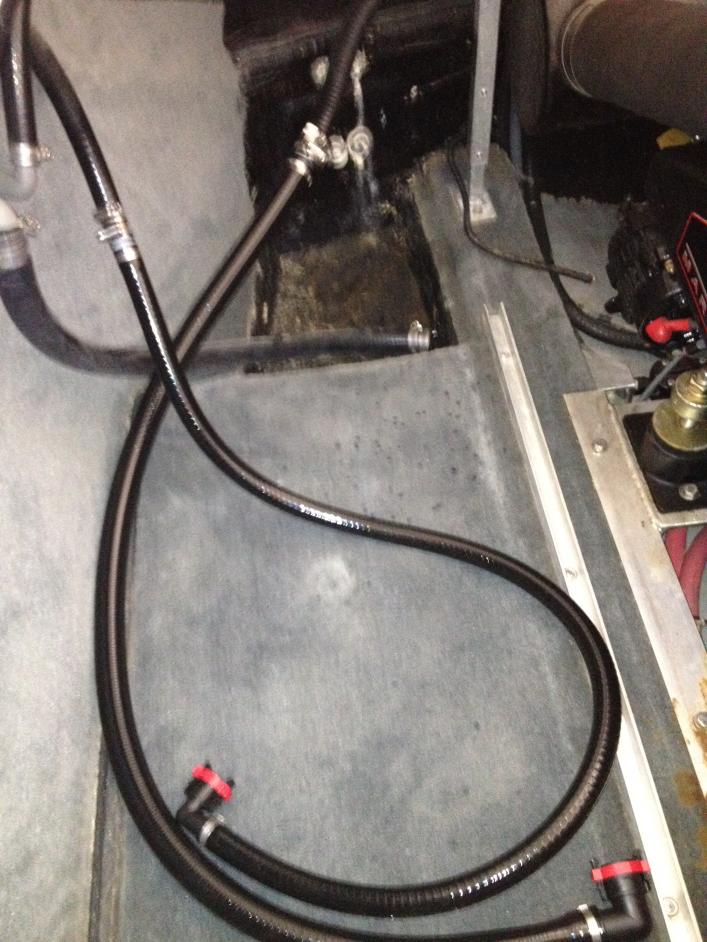

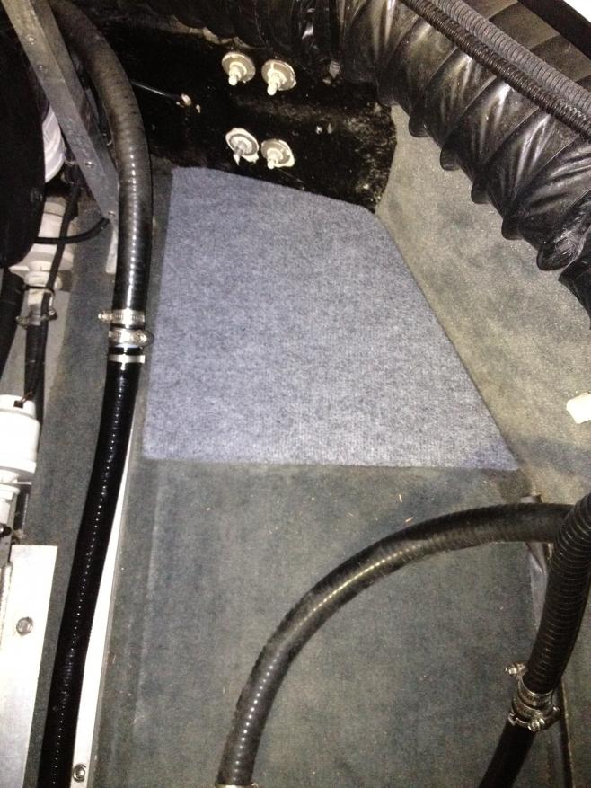

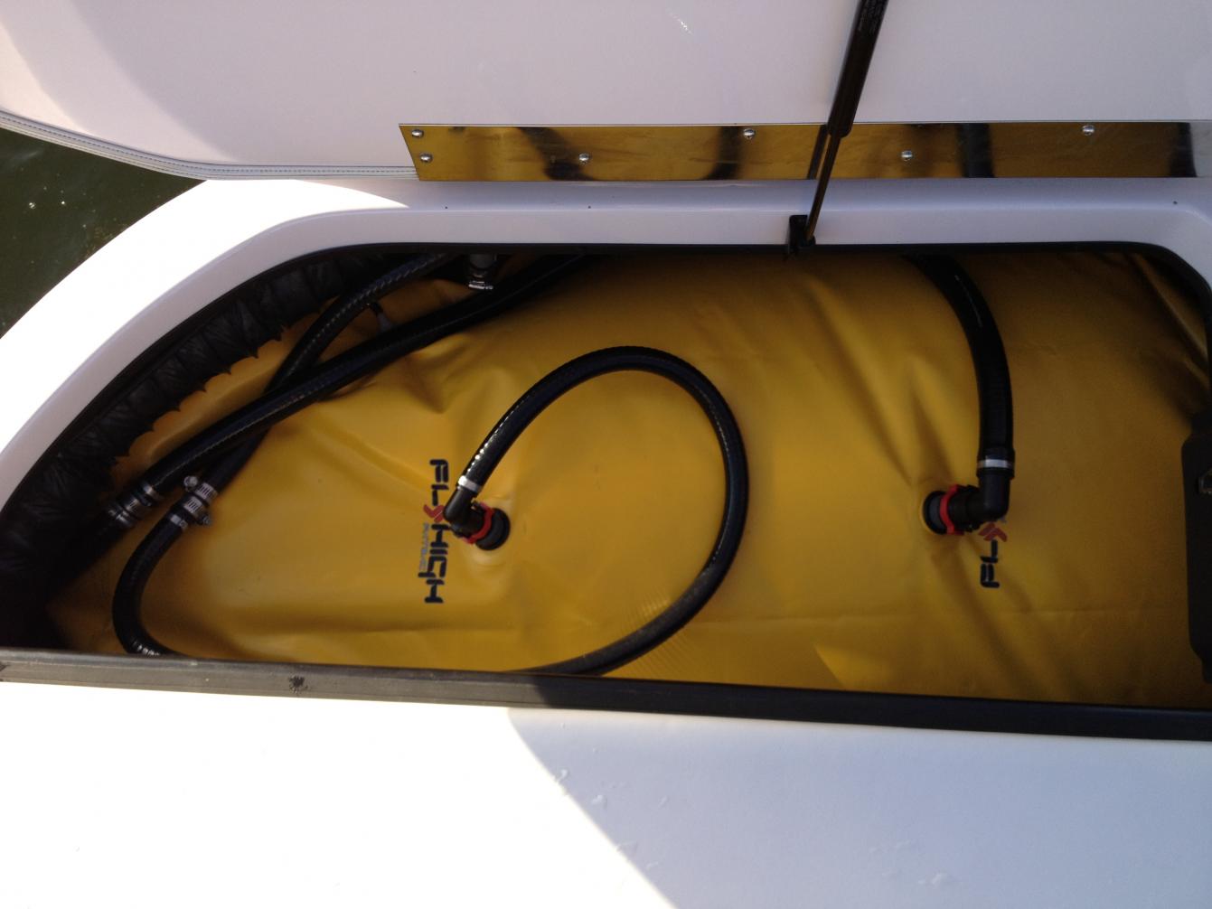

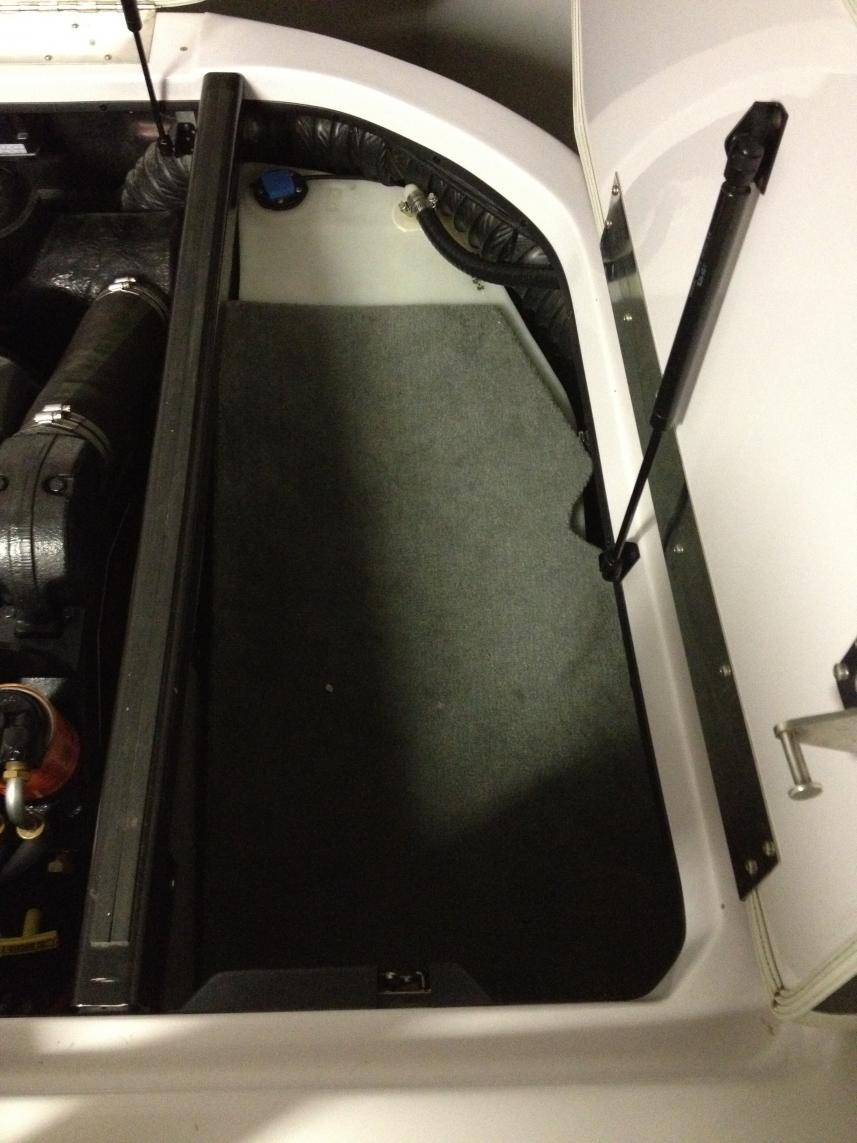

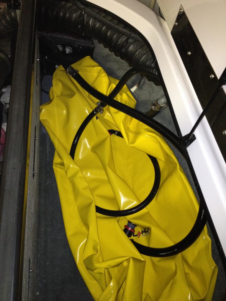

                    I took out the hard tanks in my 03 sante and used wakemakers package 750lbs. I kept the ski locker hard tank and usually just fill a 500lb fat sac and throw it in the bow. I really like the wake with the 750's but do miss the storage room with the hard tanks. I was thinking about pulling out front cooler as well but use storage space in bow for stuff
                    here are some pics of my install.

                          G
                          i used existing pumps and just used the wakemaker hoses attached to factory hoses. still control ballast pumps from driver panel. there is a pump attached to the bottom of the hard tank that you need to remove and place at the bottom of the 750lb fat sac. i have a pic i can upload tomorrow. thats why you can see that cut-out that I made to level it all out. dont know if you need to do that but i had some plywood in the garage and just threw some carpet on it.
                          this job only took a couple evenings and isnt too hard. just remove the hard tanks and and attach the wakemaker hoses to existing hoses. screw pump that drains water onto the fat sac and you should be good. let me know how it goes if you do it and if you have any questions hopefully i can help you out.

                            now thats what i wanted to hear am running the 1236 already so im ready to slam it out, haha. i see the holes towards the back where the empty pumps were under the hard tanks, did you leave those pumps in that cavity? im just thinking about what i keep in there today, and guess i can leave stuff on top of the bags when in use ... life vests, ropes/handles, etc ??
