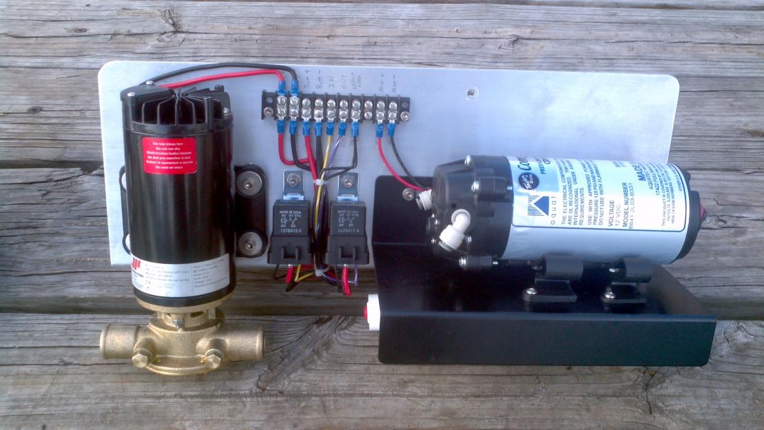

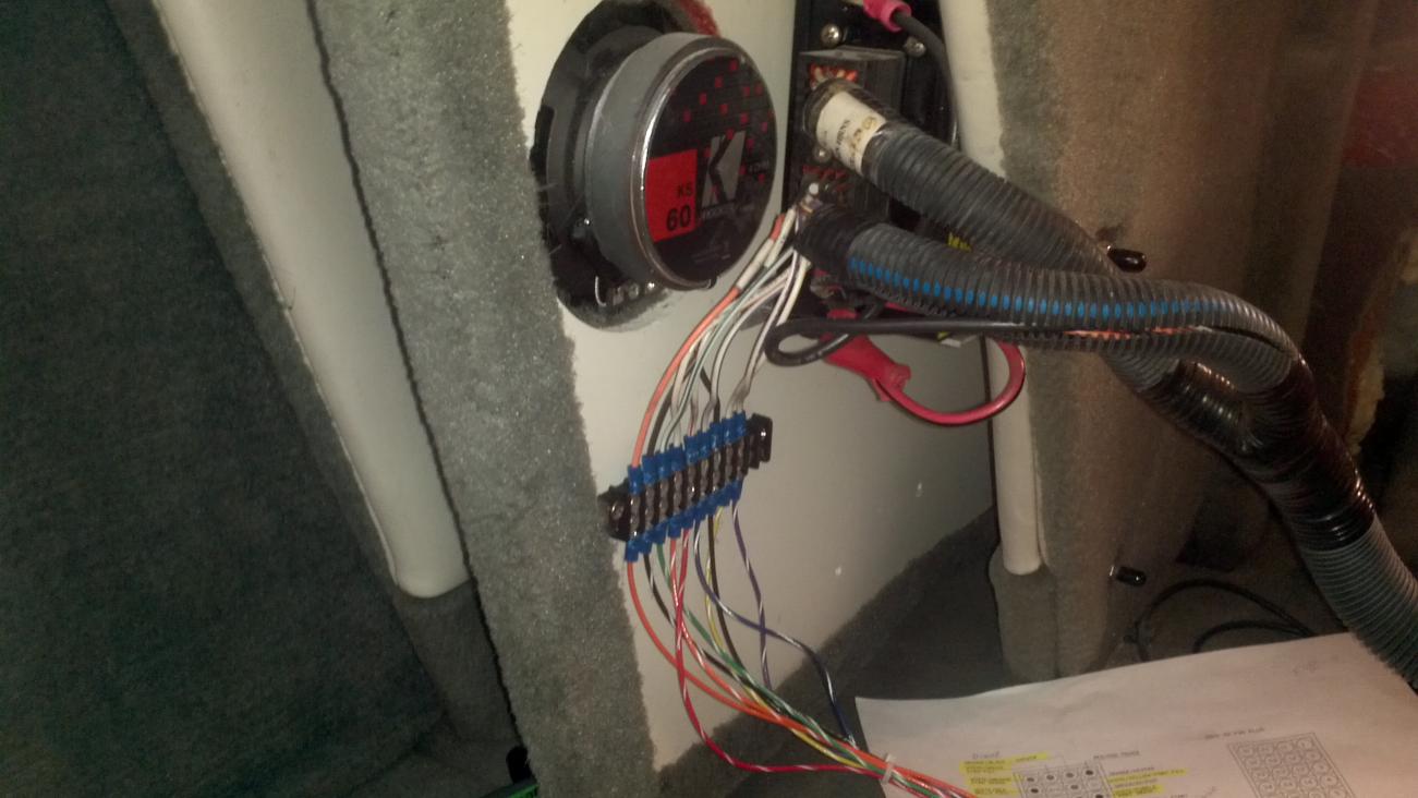

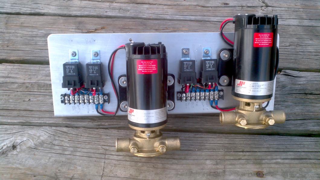

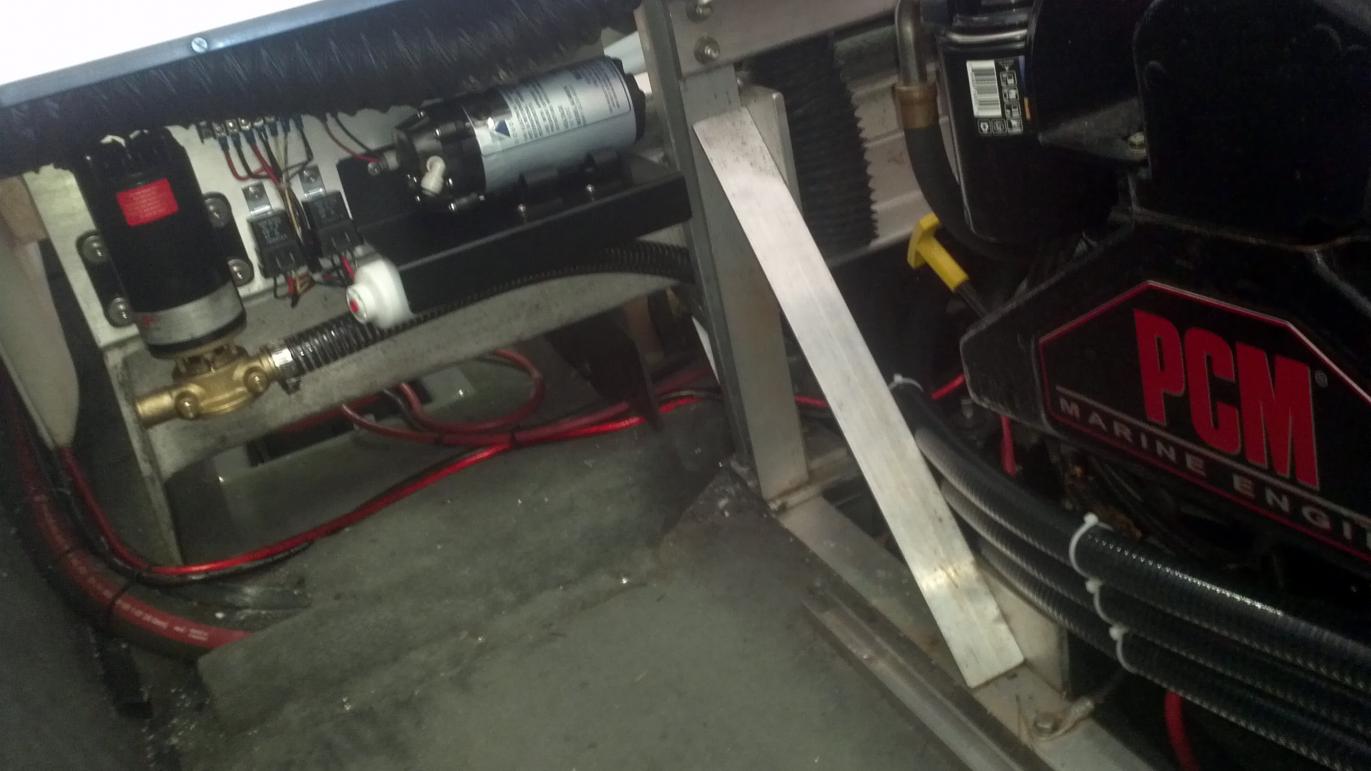

                  My boat didn't have any ballast from the factory. I wired the relays to be controlled from the factory push buttons by tapping into the wires that came out of the factory relay box (behind the driver kick panel in my boat). I fabricated an aluminum mount for my ballast puppies and the relays and mounted it in the forward part of both rear compartments. I have the belly and starboard pump in the starboard compartment, and the port and misting system pump in the port compartment. I drilled a 1" thru-hull to fill and drain each ballast pump.
                  Heres some pictures.....

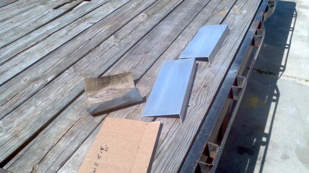

                        I did something similar to what CA did above, however I made 2 aluminum mounting brackets and attached them to the bolts that stick through the hull on the 210 for the swim platform. I made a little divider out of the carpeted material that CC puts on top of the hard tanks to hide the pumps and dampen some of the pump noise. It also helps to protect the pumps from the fat sac expanding into them. I bought a small relay box and that houses all of my electrical stuff and mounted that behind the rear seat.

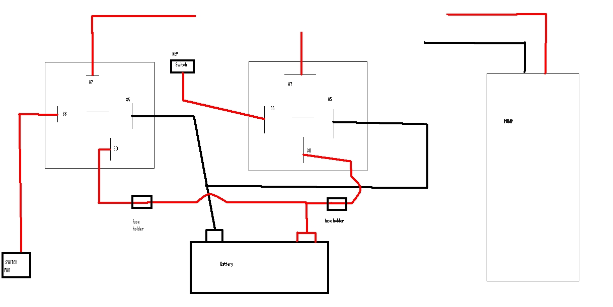

                          I am a little confused on how to wire up the relays. I have attached a drawing and someone show how to make the pumps go foward from one realy and reverse from the other?
                          2003 226 LE
                          • C.A.
                            • May 2011
                            • 32
                            • Umatilla, FL
                            • 2015 G23 Coastal 450
                            What you're missing is the 87a terminal on the relays. When the relay is not energized, that provides the ground for the pump while the energized realy provides the positive. Here is the hand-drawn sketch that I made when doing my wiring. Sorry it's pretty messy, I don't have time to clean it up right now but can later if you need it. BTW- this is on a 2004 210. I assume the wire colors would be the same on your 2003, but you need to verify that with a voltmeter.
