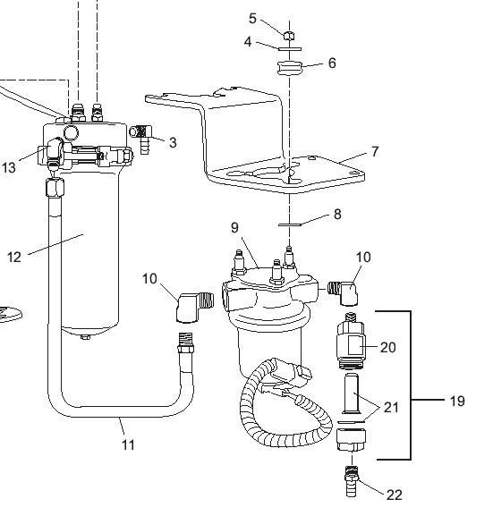

Have an 05' Excalibur SBC 350 (206 SNOB) that is having intermittent problems of simply dying out typically in gear at idle or just coming up off idle. Each time it occurs the next day or adding fuel (thought bad gas was the culprit initially) seems to resolve the problem and it fires up again, runs fine until the next event. It currently is running, at the moment.
Boat runs perfect otherwise so ruled out tune-up, etc., have bypassed the lanyard to rule it out, the FCC filter was new as of last fall, fuel is fresh and contains no ethanol.
Have heard there may be another in-line filter before the LPP (low pressure pump) however I cannot locate it, anybody know where it might be?
When the ignition is cycled on, by touch both the HPP (high pressure fuel pump) and the LPP are cycling on normally, which should rule out the fuel pump relay or fuse.
I am leaning towards the LPP being bad however before I replace a $150 pump I wanted to see if any of you have a known way to determine otherwise or if the problem lies elsewhere.
Have not put a fuel pressure gauge on the schrader valve (60psi is norm)cause that requires a trip to the mechanic, and even if that is low which pump would be the cause?
Thanks in advance for your time and thoughts!
