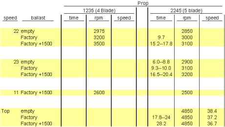

                    The water was rough and I will test again but here are the stats that I have.
