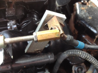

    The throttle connection on my PCM disconnected yesterday. See attached photo. I sent the photo to my Dealer and he said I could reconnect the cable but the end of the long bronze-colored connector does not have threads on the right side so that did not work.
    I searched DIY and other sources and am unable to find any help on this issue. Can anyone help? We really appreciate it!Click image for larger version

    you need a new cruise control servo cable from perfect pass

      mms1191:EXCELLENT ADVICE. I replaced the cable and we're ready to roll. THANK YOU!
