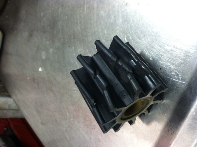

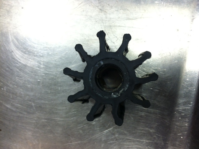

I have owned the boat for 125 hours and figured it might not be a bad idea to change the fresh water impeller. Before I purchased the boat I was told it was just changed. What I found surprised me for being in clean water most of the time.

It actually looks like you had a lucky break. If one of those blades tore loose, it would have torn apart the rest and get sucked through the pump and into the hoses, and worse, possibly the engine cooling system. That becomes a huge pain. I replace my impellers every 50 hours or so, roughly 3-4 times per season, as well as before the season begins (since we do not typically need to winterized our boats in Arizona). For a $40 part and less than twenty minutes of work, I figure I would rather be safe than sorry. I also carry spare impellers and tools in the boat so I can change it while on the water if needed. Has happened before and saved the trip (Tuesday mid afternoon of complete glass).Eric, Phoenix AZ
