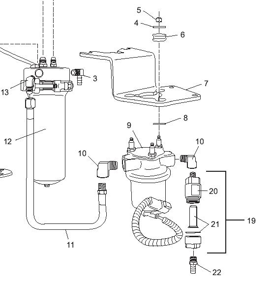

        Some years? 05,06? have a pre-filter as shown in item 21 of the sketch below.

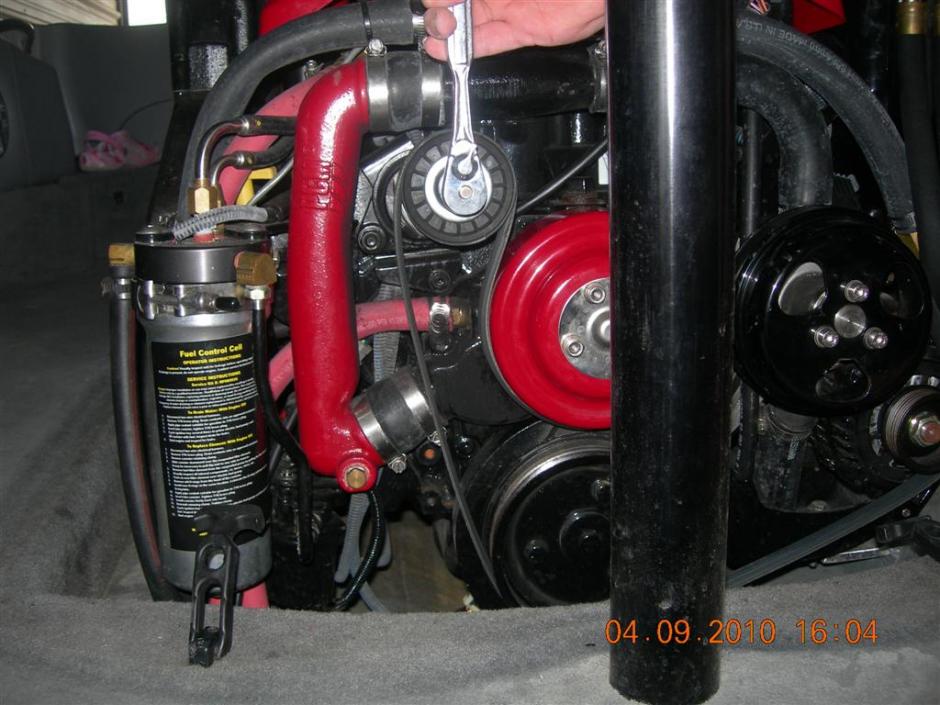

        In the pic on the right, you can see the band just below the black housing. If you look closely, there is a black plastic slip-on cover protecting the threads of the band's bolt. Its just to the left of the fuel supply line and directly above the "C" in "cell" on the label.

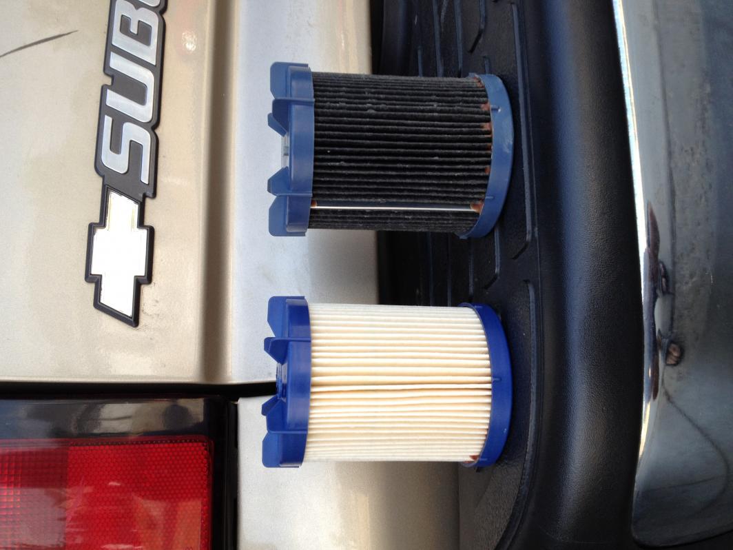

                      Just wanted to let the forum know and those who search in the future what a dirty fuel filter looks like and yes it can be a source of engine trouble! This one had 220 hrs on it. I planned on changing it in the fall but thought like many others that the every year change was over kill. I mean who changes them in your car???? Anyway I had my 08 San 210 loaded up pretty heavy with ballast and people last monday and she struggled more than I thought it should to get on plane. Also when making turns it would sometimes die/lose speed come of plane. At first I thought it a Zero Off issue. But then it started doing it during runs, did this about 5 times. Anyway we where done for the evening and I drained everything an made the trip back to the launch and it died out 2 more times on way back to launch running at about 28mph. I changed out both the inline and fcc filter and all is good again! Gets up on plane much better now and no more cutting out while riding. Click image for larger version
