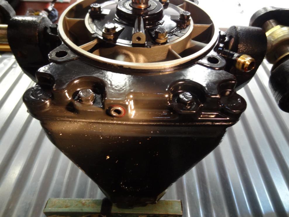

            Thanks for the Help. The transmission came back out in like 45 mins. Amazing how much faster and easy it is when doing it for the 2nd time LOL. I found the leak. It was comming out from around the drain plug threads. I took it out and put some teflon tape on the treads and put the drain plug back in and filled it back up and now Im gonna let it sit for a week b4 i put it back in and see If i have any more leaks.
