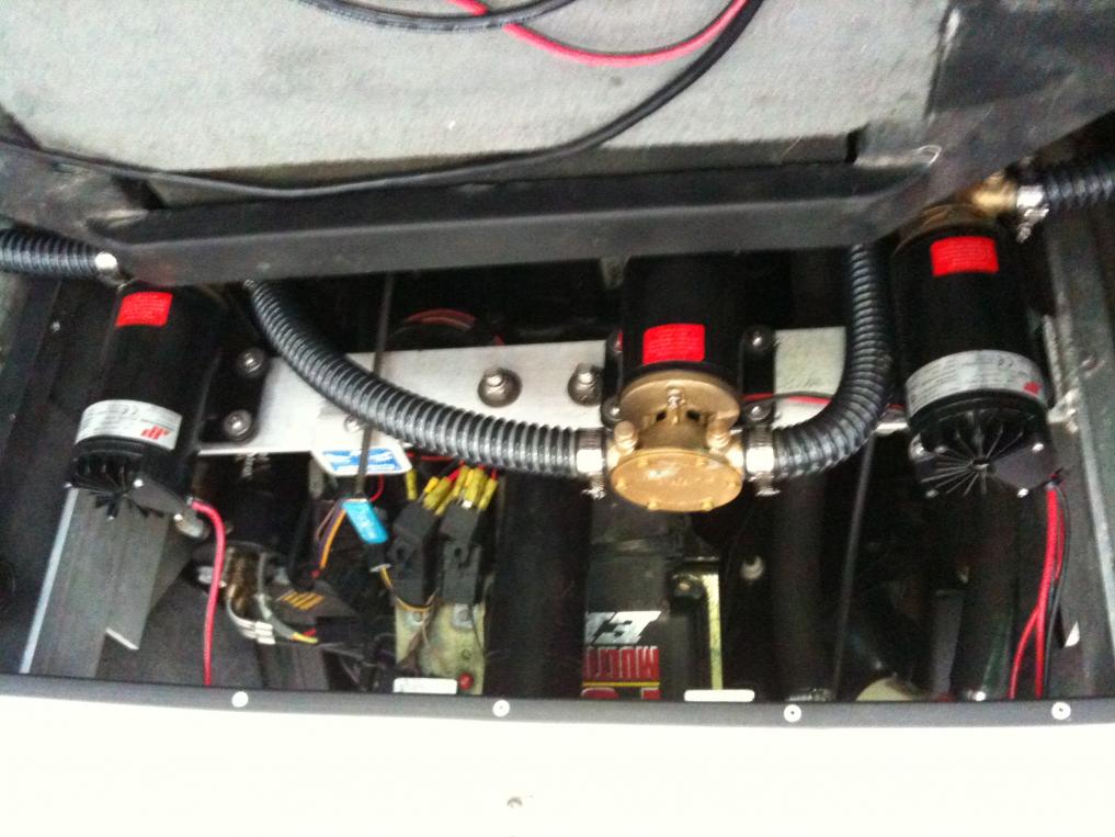

    I will take some pics and post today. Basically I pulled the flimsy carpeted divider between the seat and engine compartment and mounted the pumps on the bow side of the framing where the ski pylon is. Just barely fits.

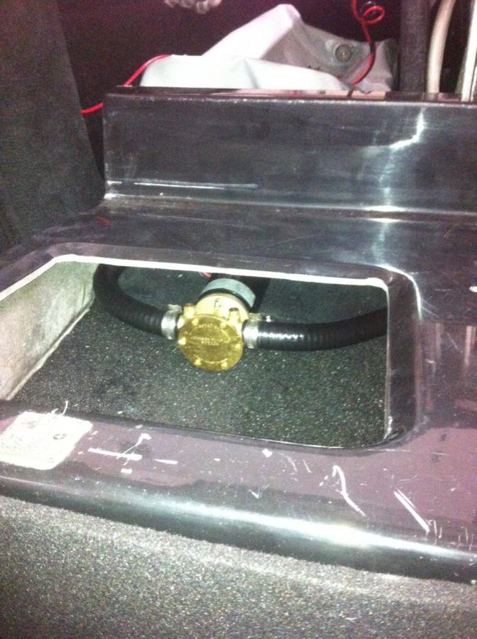

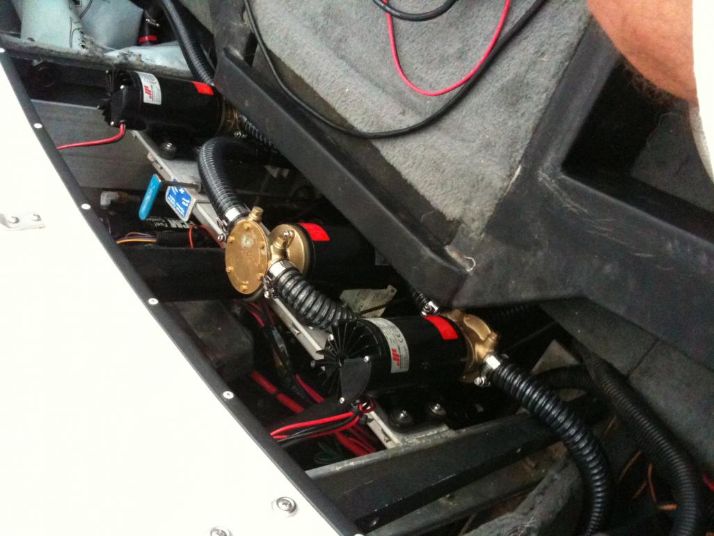

        Here are two pics of my pumps. I cannot stress enough that they just barely fit (on my 2000 SAN). I have to say that God was with me when I installed these. I did made sure the seat back had enough clearance, but I did not double check the seat bottom frame. I had an "oh crap" moment when at first I could not get the frame back in. Then I found that I just had to do it a certain way. The factory aluminum cross beam was just tall enough to get 4 bolts in per pump. You have to measure carefully and account for the 90 degree bend in the bottom (i.e., you have to drill the top 2 holes closer to the edge than the bottom 2 holes, per pump).
        I have confirmed that there is no vibration in the seat back from these.
        For anyone else reading this thread, Jabscos might have too large a diameter to fit there.
        I really will try to do my write-up tomorrow of all of the lessons I learned the hard way.

          Sorry about the first pic being upside down. It is right side up when I open it up on my computer.

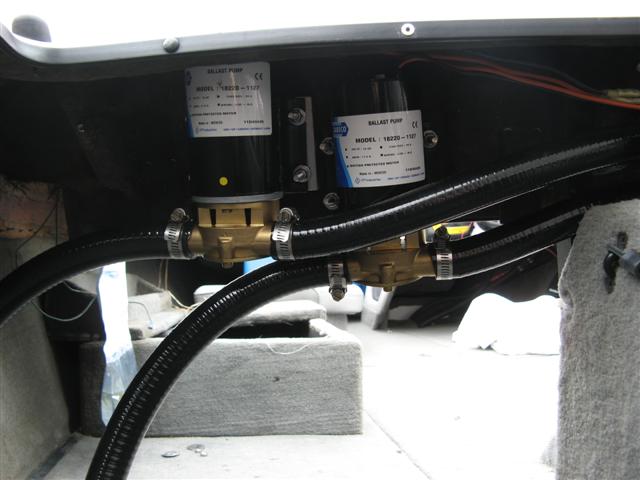

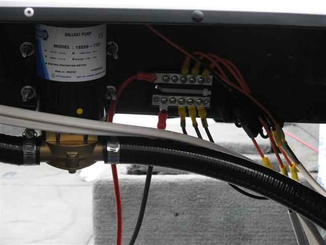

                i mounted mine to the glass behind the seat backs...plenty of room...plently strong...seat still fits fine...30 hrs and no issues yet...Click image for larger version

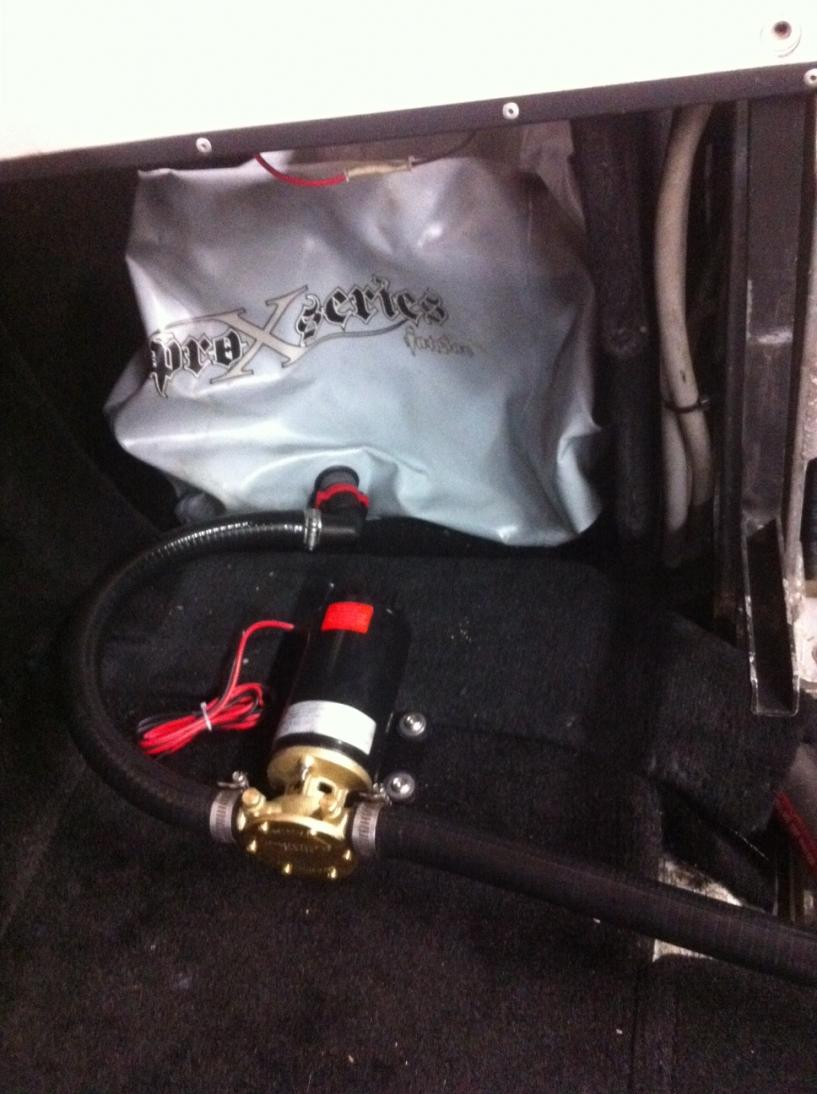

                  I'll post pictures of mine soon... I've got one under the seat that has the battery under it, one under the back bench seat behind the driver (far enough back I can put my batter jumper pack under that seat still, and then one mounted upside down in the center locker. Works good so far! I have them all wired to the dash with 3 rocker switches. Wake = AMAZING now.
