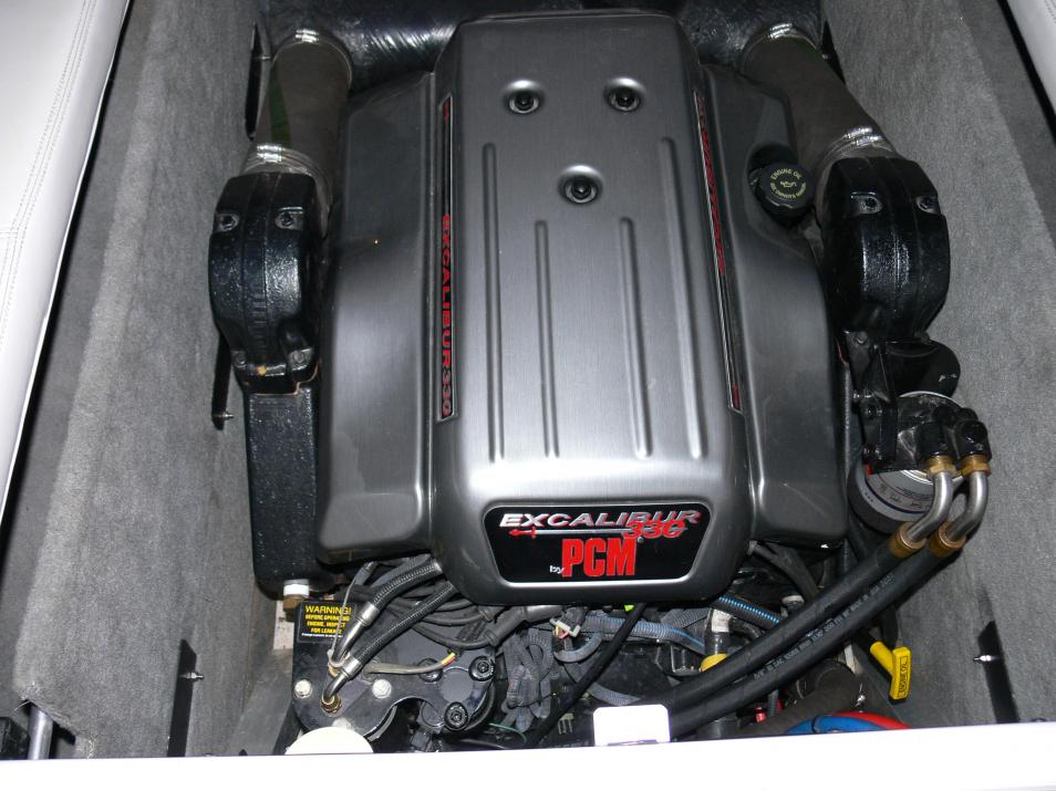

              • wakehead
                • Dec 2009
                • 240
                Here is a picture of the engine I have in my boat
                210 SANTE
                • TRDon
                  • Oct 2007
                  • 722
                  • MN
                  • 1985 2001 1993 Sport carb GT40 2003 SANTE Excalibur
                  No, the serial number is on the cover of the raw water pump.
