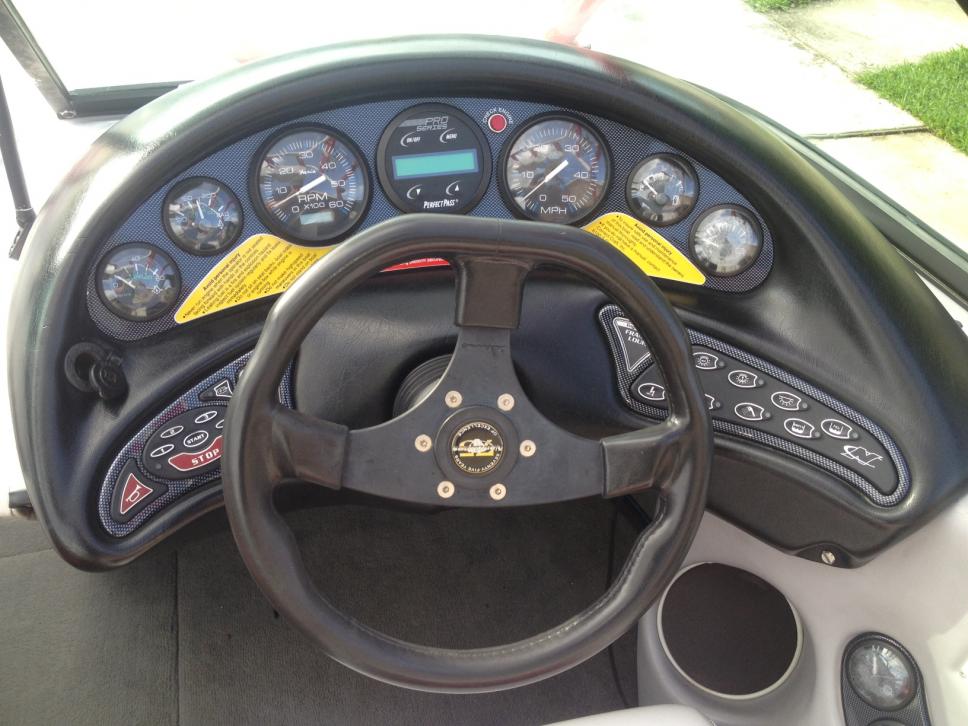

      Analog the previous owner replaced the gauges last year, but the speedo gauge isnt working properly.

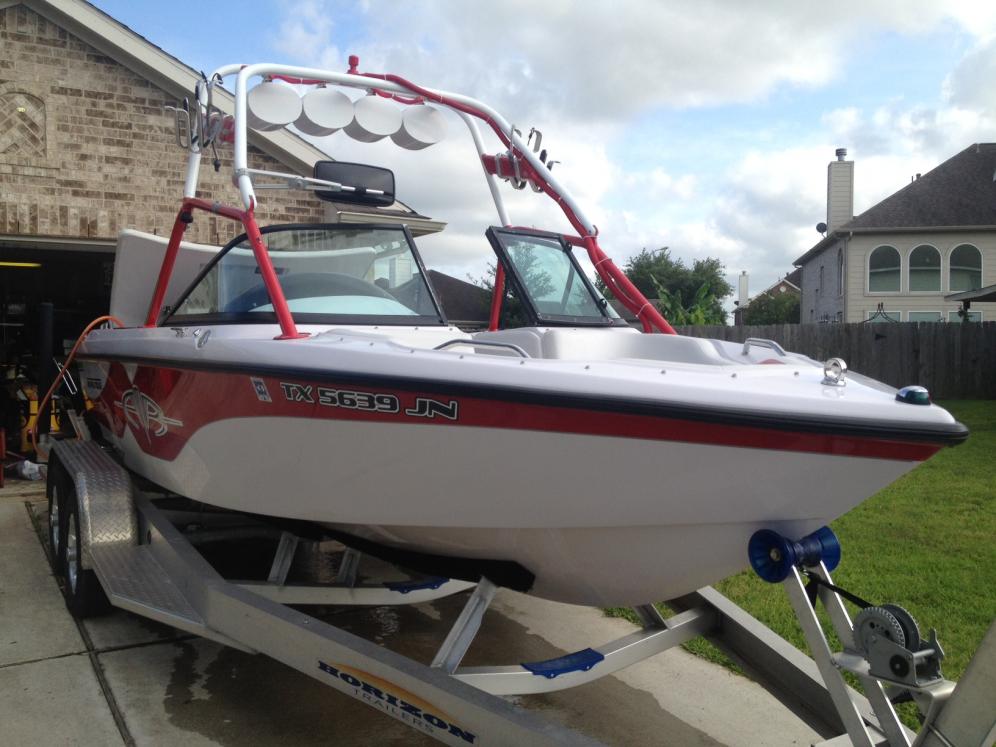

        Here she is.....

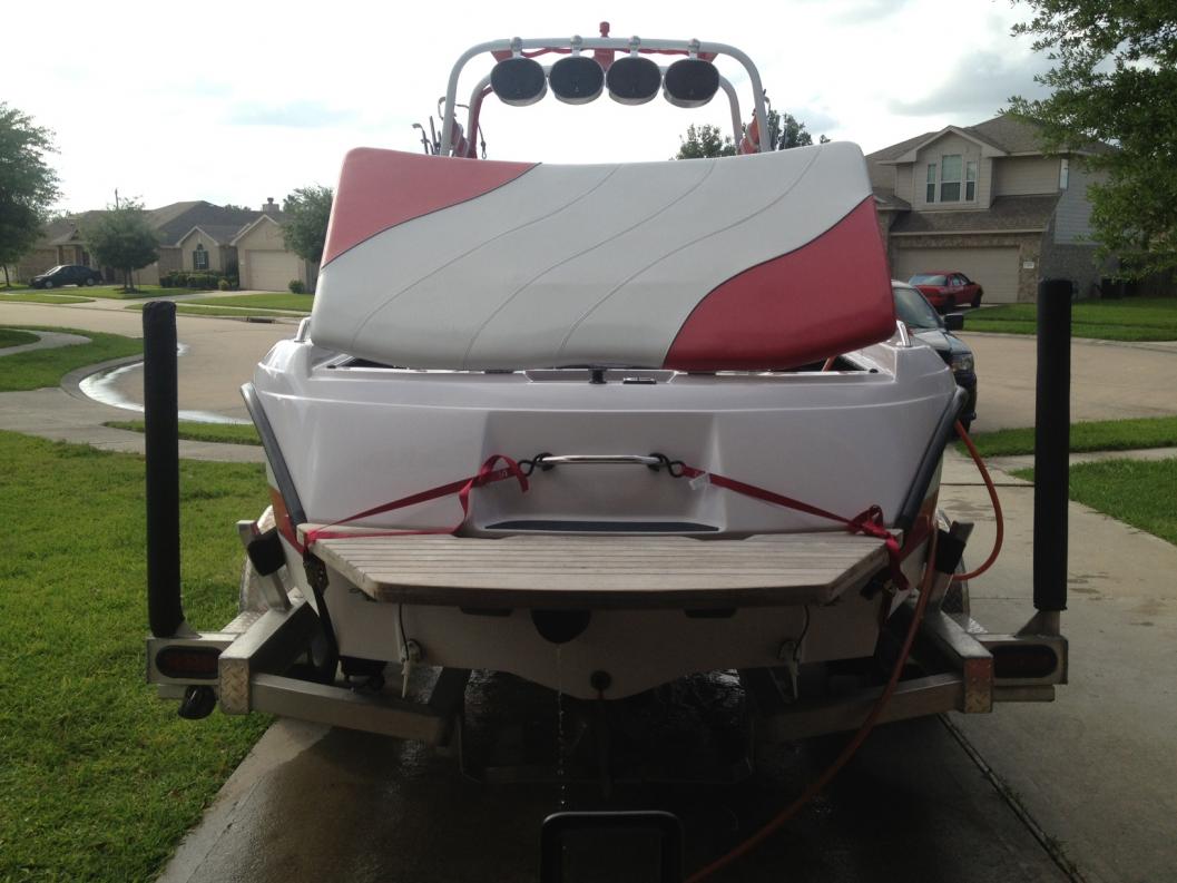

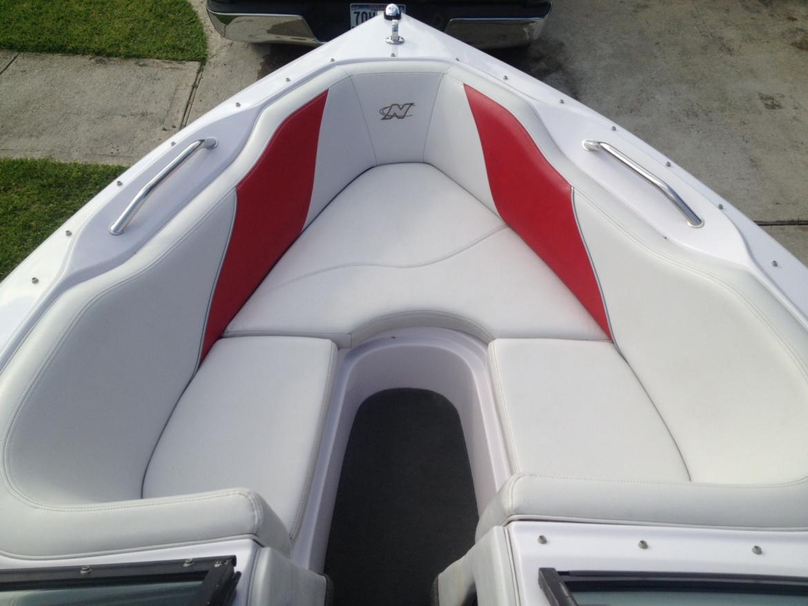

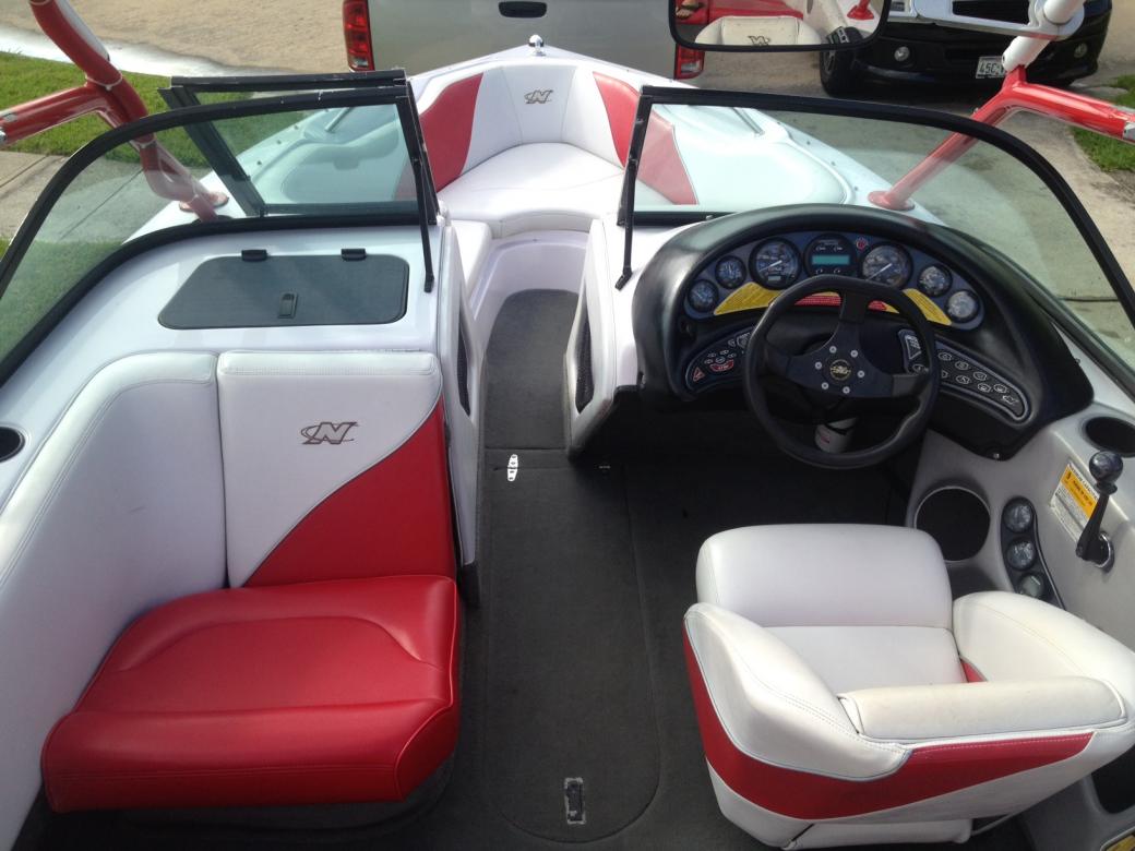

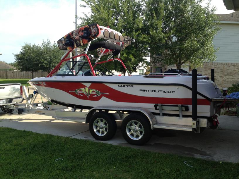

                              Nice, real nice. That is one clean sharp looking boat. Congratulations!
                              I really loved my '03 Premier also. I can't tell from the picture, but those kinda look like Byerly boats to me.
                              Thanks for the pics.
