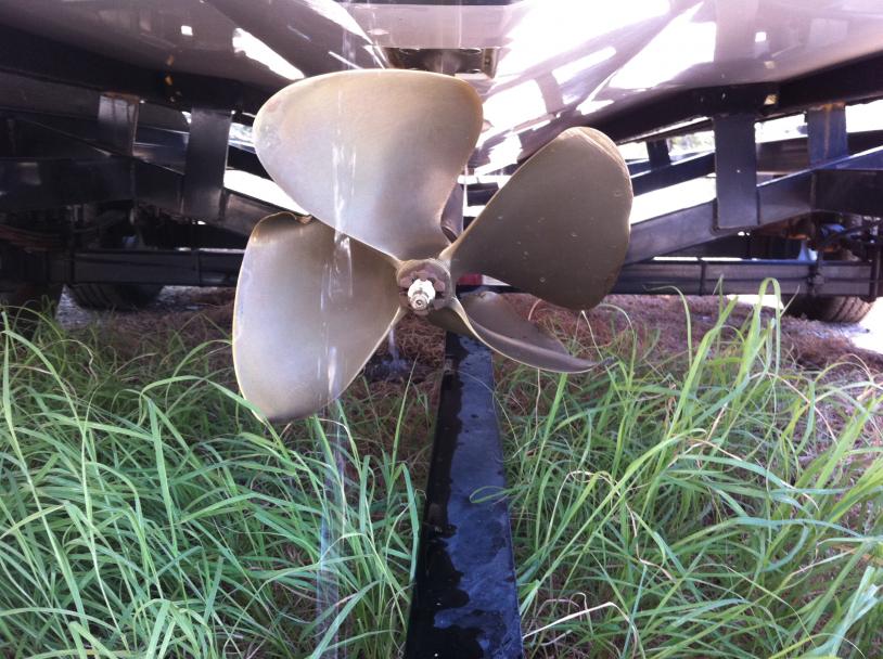

    Ok, here we go. I ran my boat aground last November due to a missing buoy. Ran aground pretty hard and bent the shaft, rudder port and prop. The rudder sheared off clean. Ever since, the boat will not throw a surf wake. My weight distribution is exactly the same as before the wreck and I've even played around with it with no results. I've measured the underwater gear against another SAN and the measurements are the same and everything seems to be in alignment. I've had it back to the shop 8 times since November and they have no clue what is causing this. The boat is weighted accordingly. 1 sac under the front seats on the starboard side partially filled, one 550 sac in the locker, 2 stock ballast tanks and 2 350lb sacs on top of those and 1 550 sac behind the drivers side. The boat lists when weighted, but when we get going, it starts straightening out and throws all white wash. Before the wreck we weighted the boat exactly the same way and it threw an awesome wake. I haven't surfed in 6 months and am becoming increasingly irritable. The shop is going to see if they can contact Correct Craft this week and see if they have any ideas.
    Please help.Click image for larger version

    You probably need a new prop. Yours looks bent....

        How can u even run on that prop?

          Surely that prop is from when he ran aground. I have no idea why you can't get a wave now though....

                      You havn't answered if you are still running with that prop! How can you even stand the vibration?

                        The picture is the prop after the wreck. I replaced it along with the missing rudder. The tracking fins/skegs were not damaged and are not bent. There are not cracks under the rudder port or strut. Stock ballast is filling properly along with piggyback ballast. Ballast is filled the exact same way as before the wreck. The 550 in the locker is moved up all the way. The 550 sack behind the driver is in front of the back seat biased on the starboard side. I have tried biasing the port side to get a wake on that side. I have tried adjusting the rudder trim tab.
