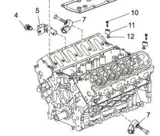

        I also thought it would be simple as unplugging, but in reference to the illustration on the manual which only showed one side of the engine and did not clearly indicate location of the sensor (#5) it was difficult to find. I have a feeling the exhaust manifold will have to be removed in order to access the sensor. could be done but laborious. also have to consider replacing seals, gaskets..Click image for larger version

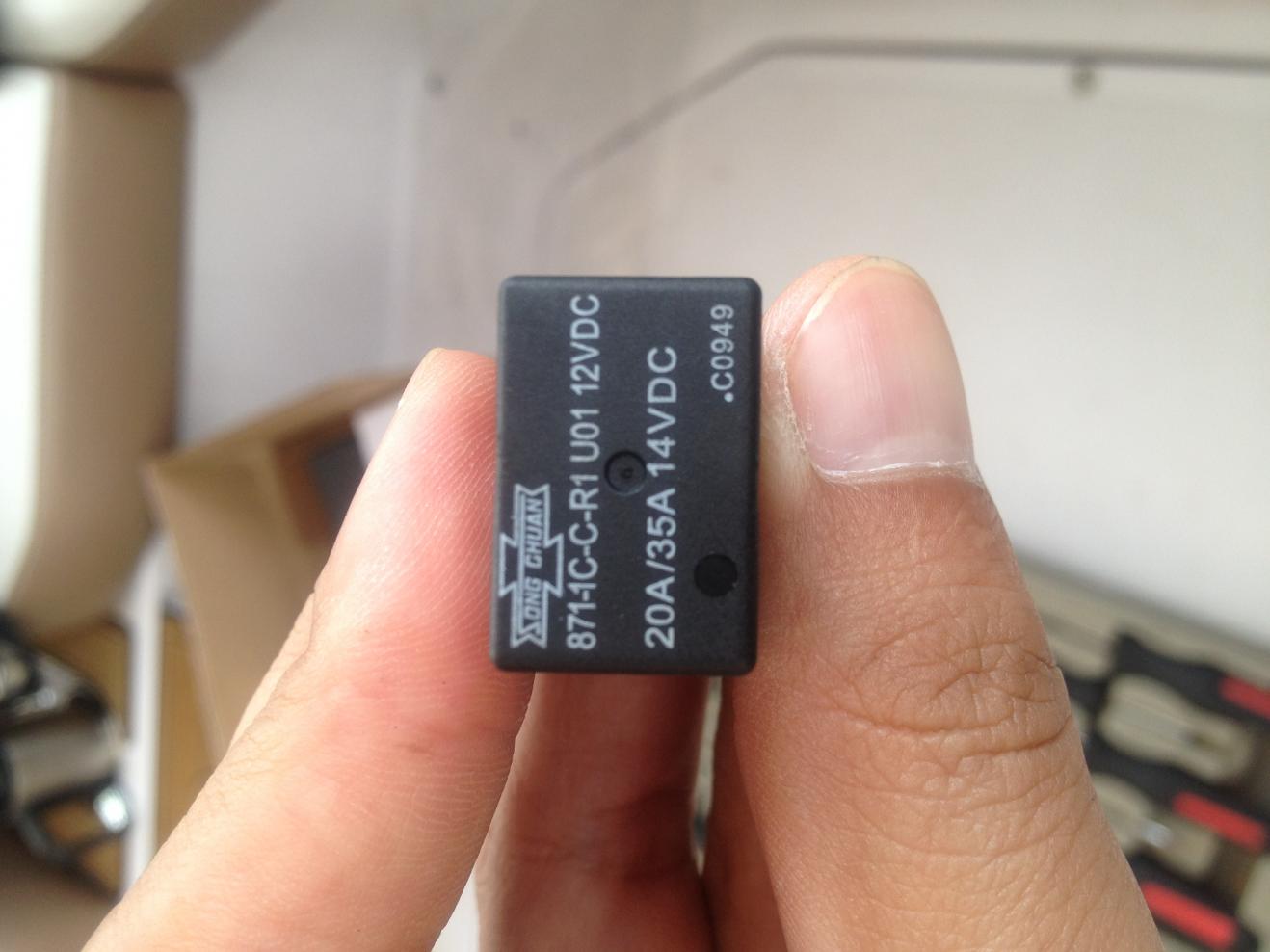

                      found the culprit! no wonder there was no spark. **** made in china parts. had it replaced with a bosch.
                      thanks to PCM & everyone else in the forum for all the tips.

                          Is that a relay?

                            Just had the SAME issueS, went through all the same trouble shooting. Did NOT pay attention that we went from a fuel pressure issue to a ignition issue after switching over the relays....Just noticed the boat wasnt starting still. Which makes now i get, both relays are needed. THREE days later we changed them over one last time and BOOM. It fired off with power going to the coil, just no fuel pressure.This was understood cause it sputtered a little from prior fuel in the line. SO then sprayed starter fluid in air intake and it fired , which was a GREAT sign! Went on a search and destroy mission around town looking for the relays. FOUND them installed them and shes all good. RIGHT IN TIME FOR THE FOURTH OF JULY WEEKEND!!
