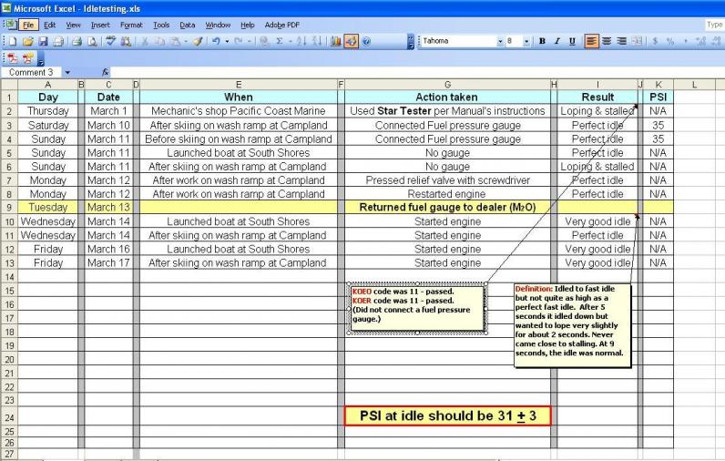

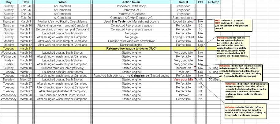

                      Boo here again. I've been keeping a spreadsheet of my engine start idles. Nothing conclusive yet. This is my first attempt at including an attachment. I've read the site's instructions on how to attach but this may not work do to operator error.

                        My most recent start information is attached. Still nothing to report on what's causing the loping at idle.
