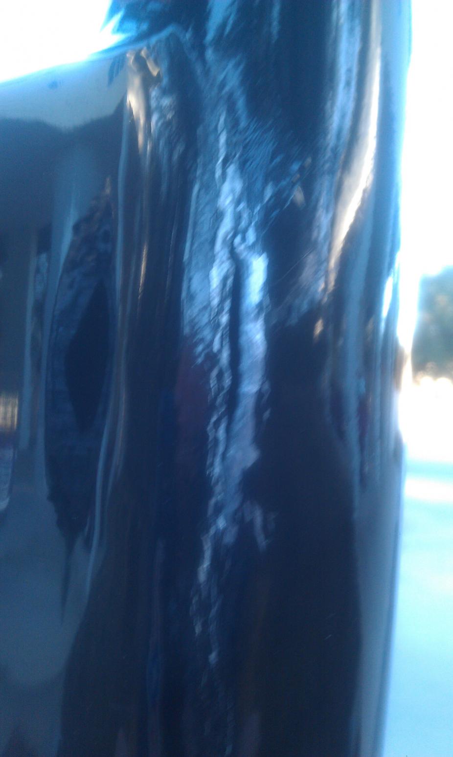

As soon as i sent the not great pics I took to my dealer, he knew exactly what is was...a freeze crack. After getting smarter on this issue thanks to several of you, I'd urge everyone to follow the procedure for the weep hole fix or get your dealer to do it. In reviewing the weather, we did have 2 nights below freezing with the lowest temp at 28 deg where i live, strong winds (15 kts) blowing on the boat. Not much really, but enough to burst the tube. THANKS to all hands that contributed and happy boating

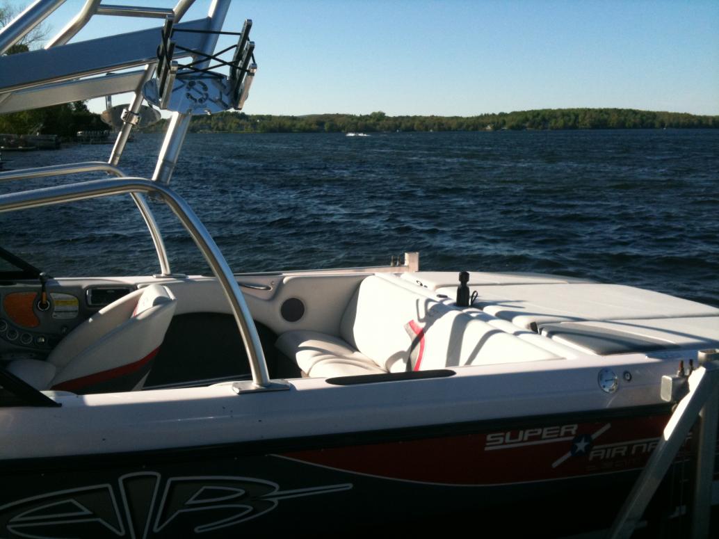

My '09 SAN is in the shop awaiting warranty approval for freeze damage to the tower here in Central Texas. Apparently, there was a service bulletin in January of 2010 to drill the drain holes. I never received and have had my boat in two different Nautique shops 5 times since this bulletin came out and no one mentioned it. The weather was in the 20's for a few hours one night in December and that's all it took. I had no idea that water accumulated in the base of the tower. Wish I had been more active on this forum and I would've known!

The only towers affected by this is the FCT3 tower and not the FCT5 tower. If you have a Nautique that was built prior to January 1st 2010 you should verify you have the weep hole drilled to prevent freeze damage. If you do not know when you boat was manufactured please contact your local dealer to verify. The weep hole was drilled in both rear tubes of the foot of the tower on the outboard side approx 4" above the gunell.

HS, speaking to Tracy at Roswell ( who I think is Roswell Wake Air), the height of weep holes is determined by the low point of a void that, unexpectedly, collected water. this makes sense to me as an engineer- when considering the tower design...where it needed to be solid for max strength and minimum torsional bending and then hollow to reduce top weight.
