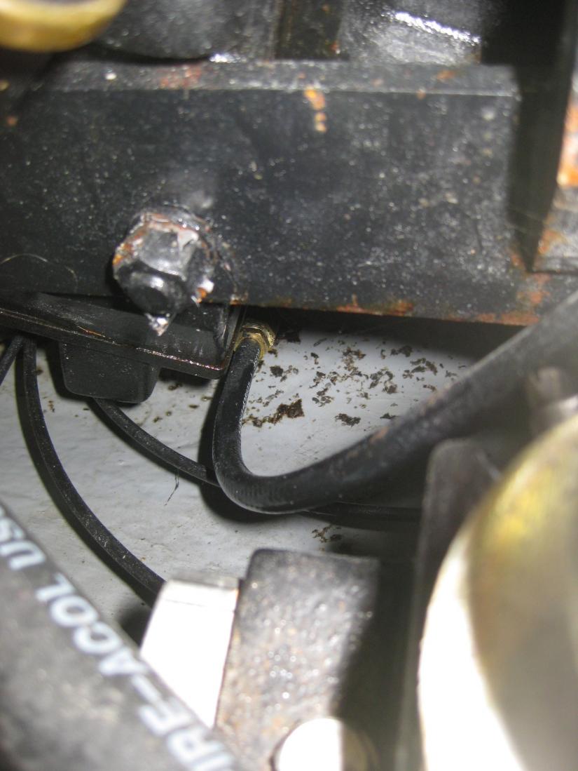

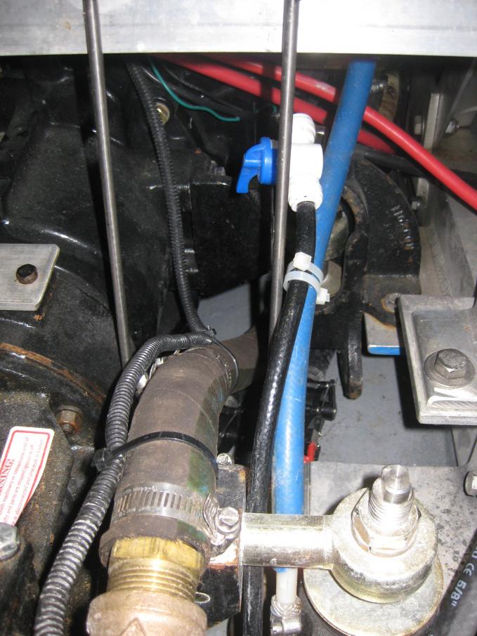

              • core-rider
                • Feb 2004
                • 1372
                • Huntsville, AL
                • 2003 Black SANTE
                Here are some pics... They were easy to get since my entire boat is torn apart right now for a stereo project I'm doing. Anyway, the little valve at the top of the pic is connected to a piece of black hose. That hose runs down to a 90 degree brass, barbed fitting. I had to get a 1/2 - 3/8 or 1/4 adapter can't remember what size to screw into the housing and then 90 degree fitting screws into it. True fully, I didn't look at the manual when I did the fluid change so I didn't know there was a magnetic plug or strainer, but the plug I'm draining from is the lowest point on the v-drive so once the fluid is drained you should have no problem puuling those without any fluid coming out.
                Guess I need to pull mine and make sure everything is okay.
                Jason
                All black 2003 SANTE
                -- Southern Fried --
                  I like that set up but man lose that speed quik plastic valve. I been in the plumbing supply biz for 20+ years and i can tell you its not rated for those temps nor oil. Pm me and I will send you a valve for free. I'd hate to see that let go on you one day.
                      I used it because it fit the tube of my oil pump. I kept the valve up high to keep the possibility of leaks to a minimum and make it easier to access. I'll PM you to see what kind of valve you had in mind.

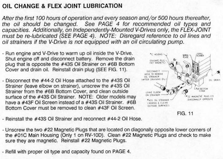

                            http://www.dublerfamily.com/Regina_o...e%20Manual.PDF
                            OIL FILL
                            The V-Drive is shipped without oil and must be filled with recommended oil before
                            operation (See below). DO NOT USE SAE 80 MOTOR OIL, OR MULTI-GRADE
                            OILS SUCH AS 10W-30 OR 10W-40. Listed below are the approximate oil
                            capacities; actual quantity of oil required depends upon the angle of installation.
                            RECOMMENDED OILS:
                            SAE 30 Heavy Duty Motor Oil
                            Exxon Spartan EP-68 Gear Oil
                            APG-80 Gear Oil
                            sigpic
